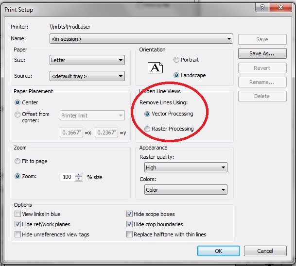

When I make a family have 100% surface transparency I can see the outlet behind the equipment family on the screen.  When I print the elevation the outlet does not show.  In 2012 I was able to make a piece transparent, is that not possible anymore, or where did it move to.

I don't think its a transparency issue if it only dissappears when printed. what if you try toggling between Vector and Raster printing; any difference?

It does look like it will appear if it is a raster, but the same condition worked fine in 2012 if I could make the family transparent.
