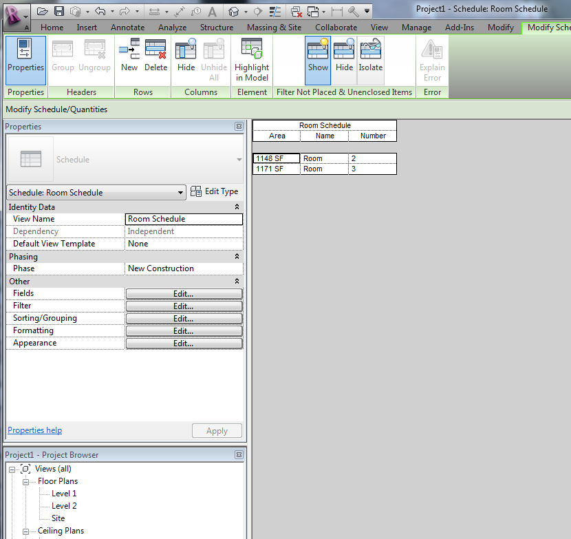

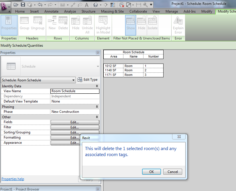

you need to make a new room schedule, add area, name and number to your schedule
then delete them from your schedule using the delete button

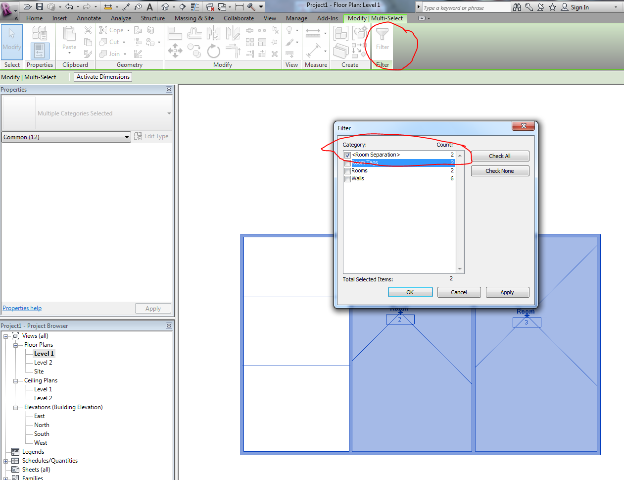

next go to a plan view where the room separation lines are visisble
select everything
use the filter to select only room separation lines (unfortunately you may not be able to right click and select all)
delete all of the room separation lines at once

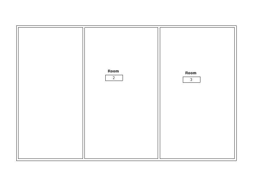

110303_delete_rooms.PNG110303_deleted_room_plan.PNG110303_deleted_room.PNG110303_how_to_select_all_room_separation_lines.PNG
