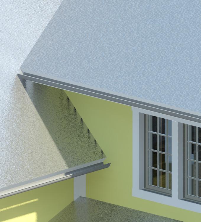

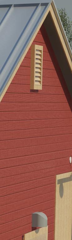

Shaded and rendered images attached.  You will notice that in the rendered version, the siding edges are invisible, except that their relections appear in the (aluminum foil) metal roofing below.
 I did try increasing the depth of the profile.  These images were made with the siding at 4x actual depth (1 1/4").

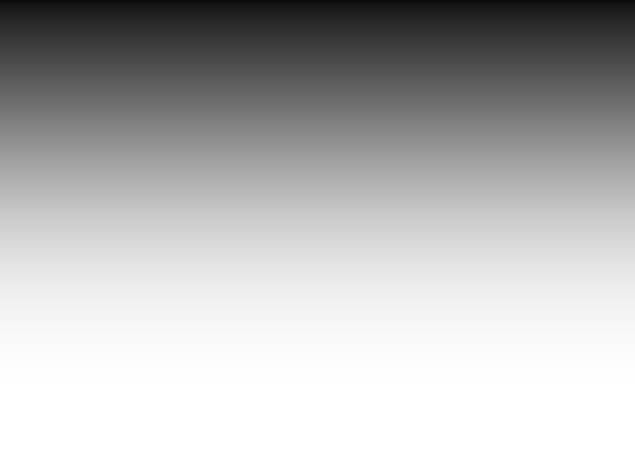

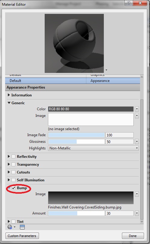

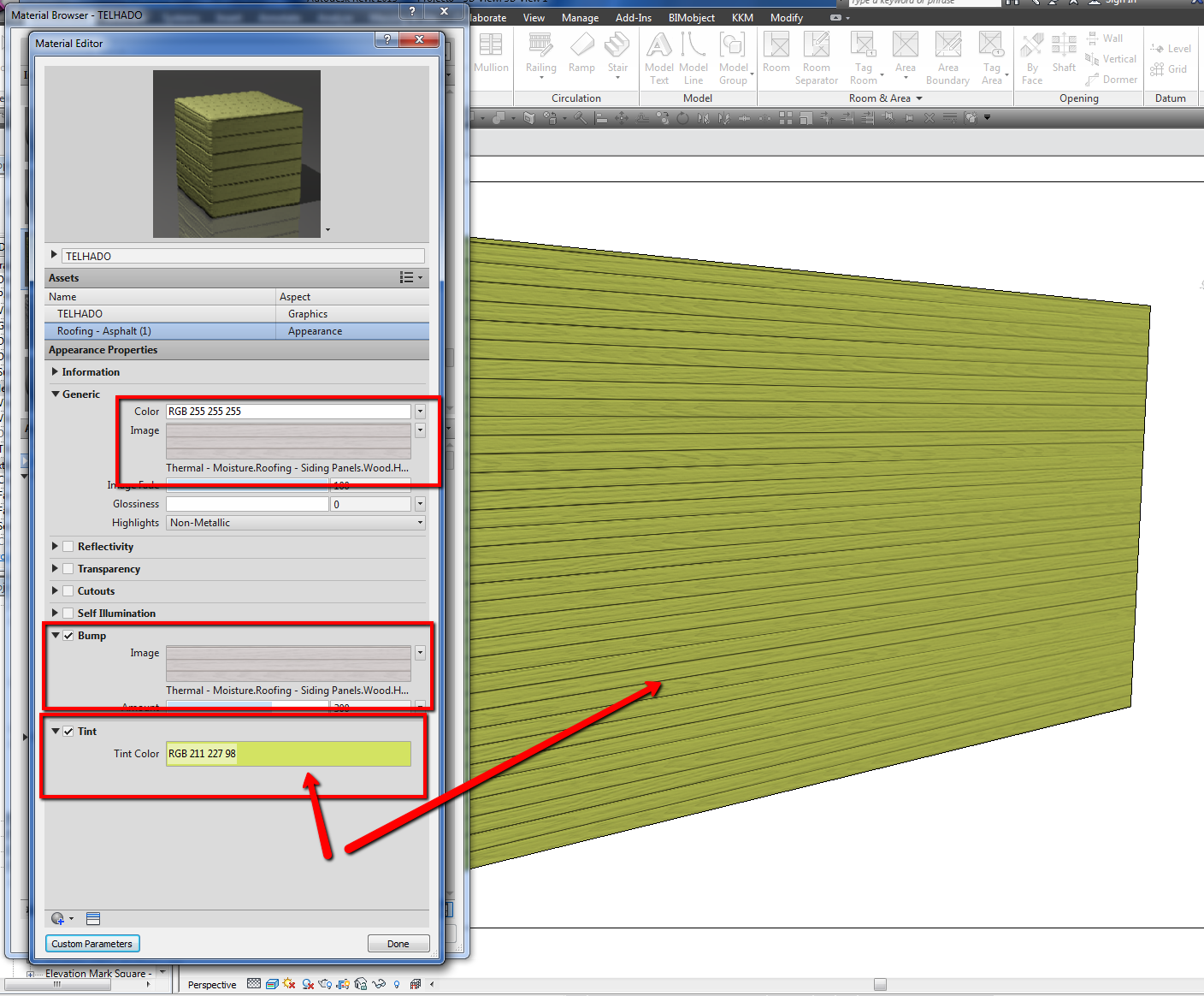

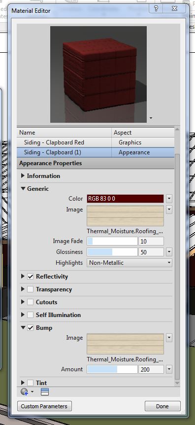

I agree with Typhoon; I've tried modelling siding accurately and it just bogs down the model.
Have you tried applying a "bump" pattern to your material instead? I've created some custom bump patterns similar to what I attached that I use for different siding patterns.
Fri, Aug 31, 2012 at 4:51:32 PM | Rendering Modeled Siding
Johnzo142
Joined: Fri, May 8, 2009
47 Posts

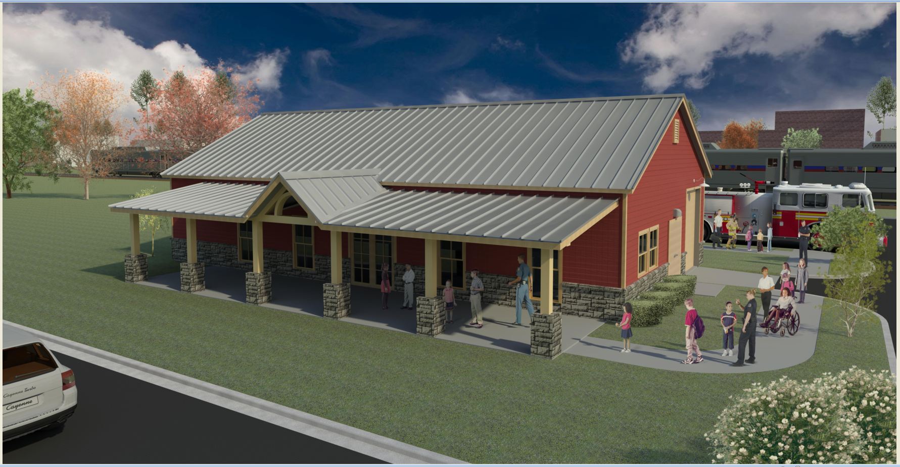

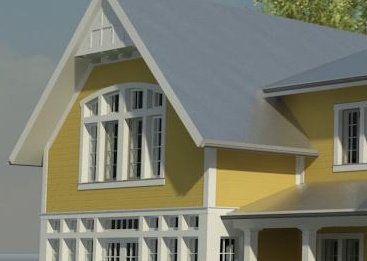

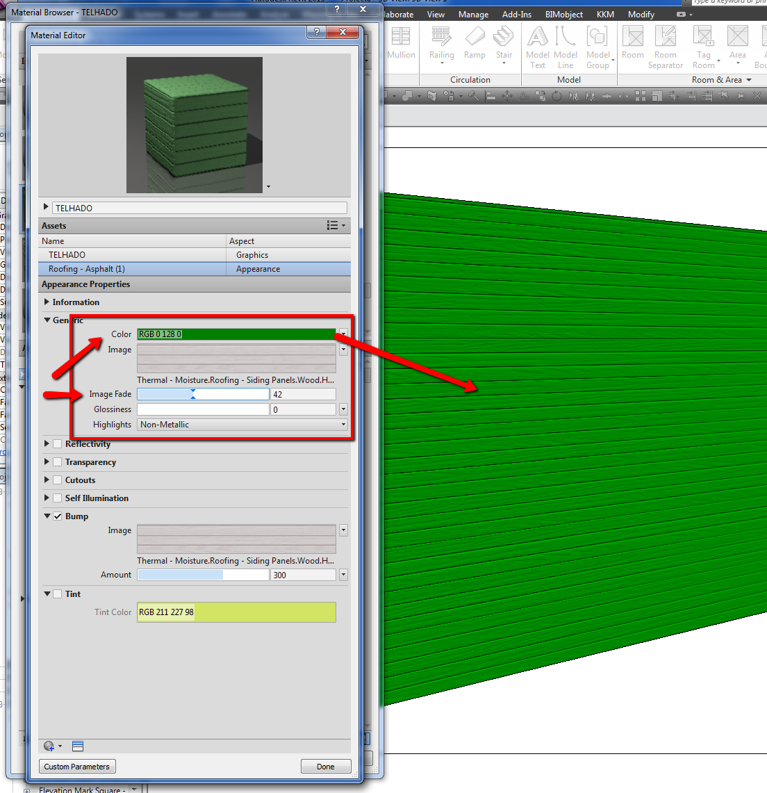

This is one that I did recently by using a color and turning the image fade down and the bump up on a standard material. I was very happy with the results.
Fri, Aug 31, 2012 at 4:53:07 PM | Rendering Modeled Siding
Johnzo142
47 Posts
Here is the entire image.

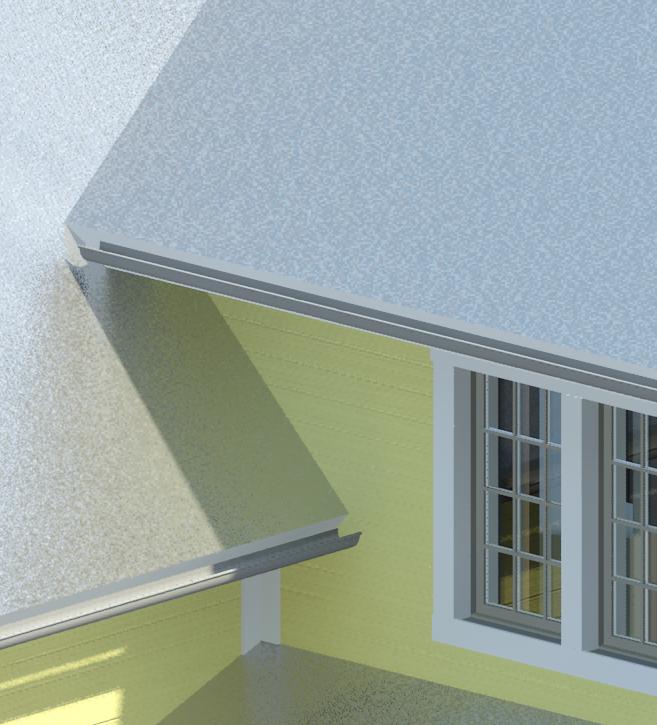

Johnzo,
Thanks for the advice.  I'm afraid I cannot duplicate your results, even when matching your settings.  Image attached.
I'm willing to take a little bog in the render time, if the results are right.  I'm disappointed that Revit cannot accurately render the elements when truly modeled, or even when exaggerated.

Choose the right texture and change the color like you want.
Render in High quality 300 DPI and check if you have the result you want.

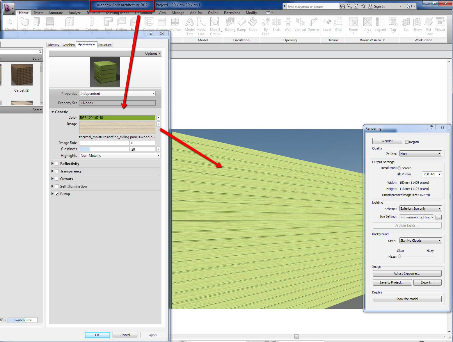

The key may be that the Generic - Color is white and the hue is selected using the Tint Color variable near the bottom of the editor.  My dialog box does not have this, nor does my dialog box look like yours.  Which version of Revit are you using.  I'm still on 2012.

I need to know if this solution is available to me.  From which version of Revit was the screen shot taken?

Was in 2013 and now in 2012....
A good "texture" can produce the effect you want without increase the file size.

Attached is my best rendering with that method.  As you can see, the siding is barely visible (or not visible).  I have tried meddling with the degree of light and shadow, etc. to try to enhance the contrast and visibility of the siding, without success.
Any other suggestions?
Thanks.
