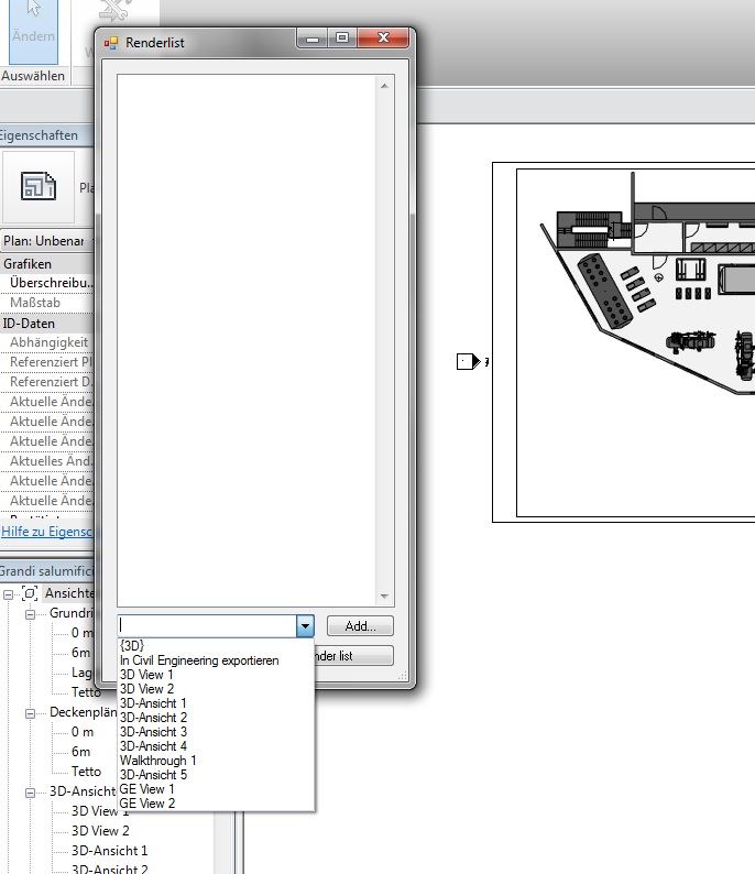

thanks, but the image size is too small there. we have to print these images out so unfortunately 360 is not an option atm.
but i am already making progress with the add-in!
does somebody have a clue what the "export to civil engineering" is? (see image)

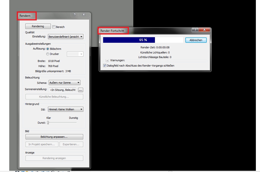

hi guys!
i am in a bit of trouble here.. and need ideas..
by now i can create a list of all renderable views, and start rendering of the first one. the problem is i dont know when the rendering is finished in order to save the picture and start the rendering of the next one..
i have 2 ideas, both not too convincing...
1) i check the active window. if it is called "rendering" then ill wait till it is gone.
-problems: the window might have different names for other languages, i need to include another dll in order to read the window name.
2) i keep opening the next scene in the list. as long as the render window is open the next scene wont open, as soon as the render window closes the scene will open and render.
-problems: as soon as the render window closes the next scene opens up, without giving me the time to save the picture witch would then remain unsaved and you would have to do it by hand. moreover i would have to use a while loop, using up processor, and that is definetly not what i want while i render.
any ideas?
regards
Igor
Check out my new Renderlist add-in to render multiple views in sequence overnight! Get it here and remember to leave some feedback Shadey http://www.revitcity.com/forums.php?action=viewthread&thread_id=28381
Fri, Aug 24, 2012 at 4:51:33 AM | renderlist
#13
frifer
Joined: Mon, Jul 30, 2012
107 Posts
5 Stars: 4 Votes
hi guys! first of all i would ask an administrator to move this topic to a proper section since it is not a help request anymore..
second i need your help! (lol.. ) i went for the first solution, but for that to work i need to know the name of the window in every possible language. the name of the windows i need are in the attached image. please provide me with the language and the name like this:
German: "Rendern" "Render-Fortschritt"
the more languages i have the more languages will be compatible with the add-in.
thanks
