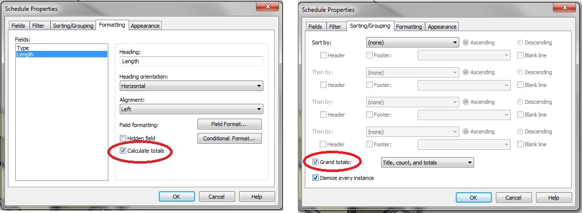

Is there a way to calculate the overall length of conduit run including bends? Also, i would love to have the total lengths show up in a schedule but i am not really sure how to right the formula for that. Anyone have any insight to that?

its not a matter of creating formulas. When in your schedule properties; ensure that your Length parameter is checked for calculate totals. Then you can also ask for grand totals if in case you have different diameter conduits and you want everything added up. I've never really used conduits so I'm not sure how it will handle the bends.
