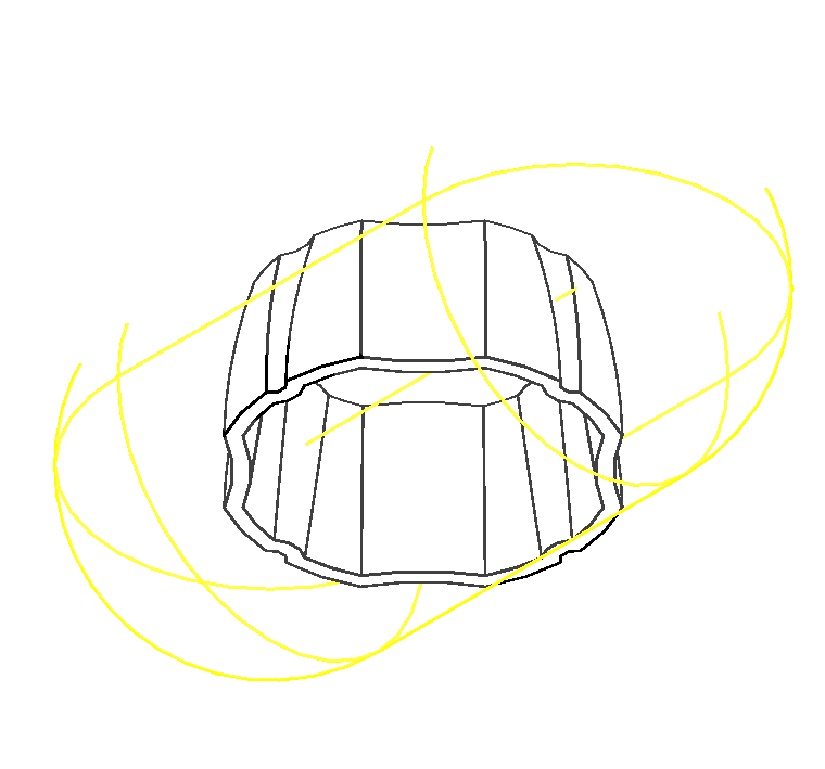

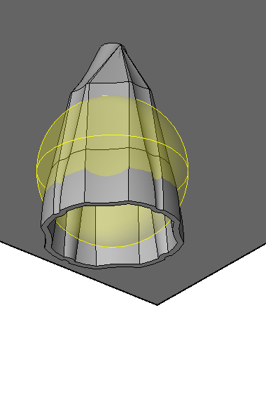

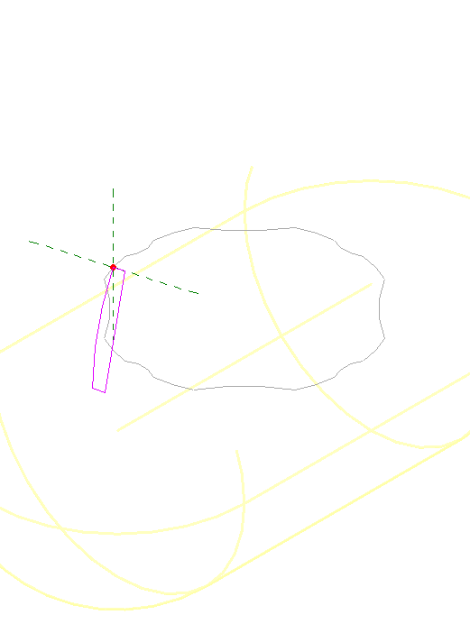

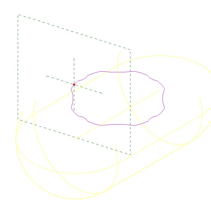

Hi Smallhands,
You could do 2 or more stages of sweeps and a top stage of a sweep. I guess you might get to a blend one stage below the top and do a revolve for the top most stage to get a parabolic curve at the top.
The sweep lets you use a series of reversing curves for a plan and a simple profile to sweep around the plan
I wouldn't rule Revit out.
See the attached images.
