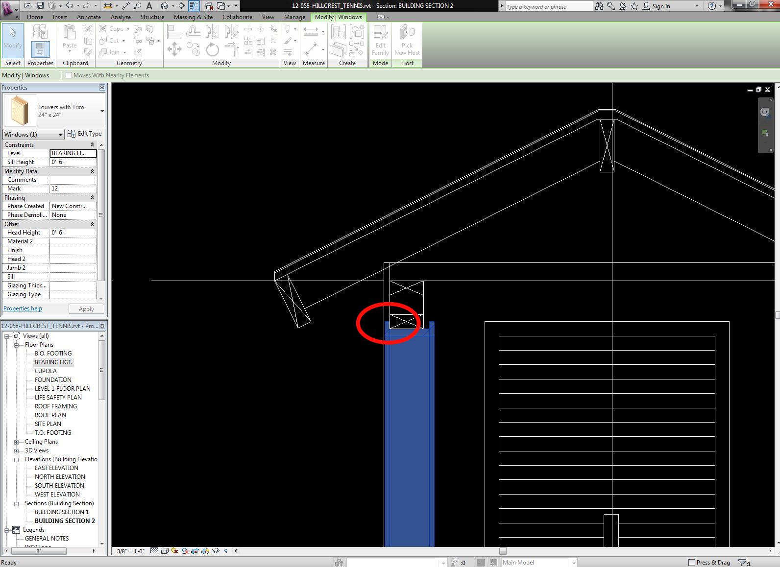

There is a setting in Revit where you can offset windows, but it doesn't appear that you can do this with louvers. I need to be able to offest the louvers so the exterior sheathing with tuck behind it and allow flashing. I used the louvers that came with Revit, they worked out perfect, I just can't seem to offset them. Any ideas?

Go into the family and add a parameter to be able to offset the louver from the face of the wall.
