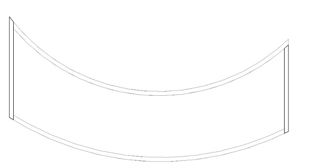

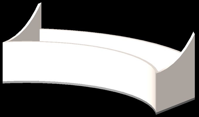

Hello,
I am having trouble trying to create a curved roof the follows the footprint of the building's footprint but also curves along the wall profile. I've tried various methods but haven't been able to get what I need. Any help would be greatly apprieciated.
Thanks

Create a MASS then apply roof by face.

Alrighty, what view would I do this in? I tried using the create roof by mass before but it just wouldn't come together
Fri, Aug 3, 2012 at 11:48:53 AM | Creating a curved roof
As ty said
  1. Create a MASS
  2. then apply roof by face.
A mass is created from the massing tab.
CURVED MASSING FOR ROOF BY FACE
