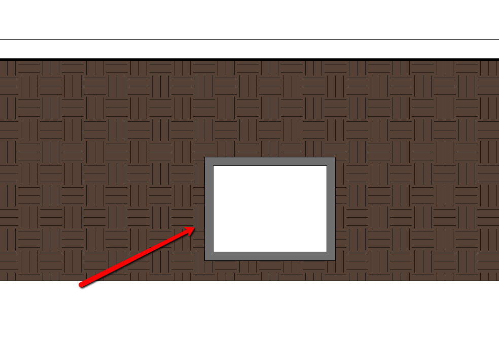

I have a need to void a tunnel through the topo surface, but can't make it work.
I have two tumnnels on is round about 15' d, and one is square about 10 WxH they follow a path through the site, I made and sweep with model in place for the concrete and it worked great but the tunnels are filled with dirt, how do I void out the dirt?
Thanks for any sugestions.
Thu, Aug 2, 2012 at 12:55:08 PM | Utility tunnels in topo
Joined: Tue, May 22, 2007
5921 Posts
4 Stars: 205 Votes
Create a "Mask region"...
Thu, Aug 2, 2012 at 3:55:31 PM | Utility tunnels in topo
NobleLP
Joined: Mon, Jan 16, 2012
20 Posts
Thanks
This is a good "work around" I would have to do this for every view that has the tunnel. Isnt this correct?
I was hoping to have the model stand alone, I guess we cant void the topo.
