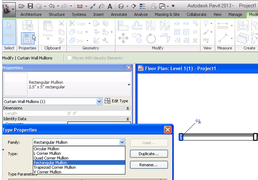

how do I make corner mullions available to select?  As you can see from the screen shot, only the 2.5 rectangular is available.  how/where do I load the family for corner mullions?

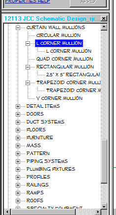

no, i'm showing that in the window at the bottom under families that there are other mullions listed there - but in the properties menu they are not available to select.  in the picture you are seeing, the "down arrow" is selected and only 2.5x2.5 rectangular is listed
Wed, Aug 1, 2012 at 9:00:56 AM | corner mullion storefront

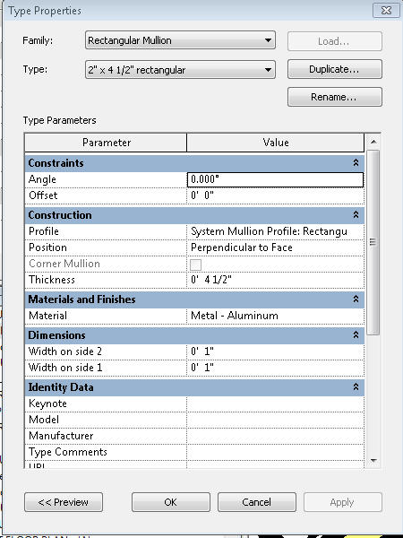

In that same properties, just below the item is TYPE.  Click that and you will get the attached image.
Create a new type and point it at the correct profile listed in your families.
This is a fundamental process.  I suggest you find some fundamental videos.

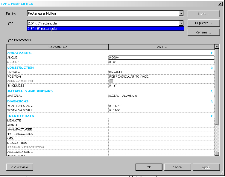

Under profile you see "DEFAULT"?  Click on that and you will get the pull down on the right to point to a different profile.  This has NOT changed.

default or rectangular (or circular?) are the only options

for anyone else who may have this problem - I've figured out the steps:
in the views window click the "+" for curtain wall mullions.
right click on any of the options you would like to use for your project and click "new type"
now, when you select a mullion and select the drop down in the properties window, it will appear as an option.

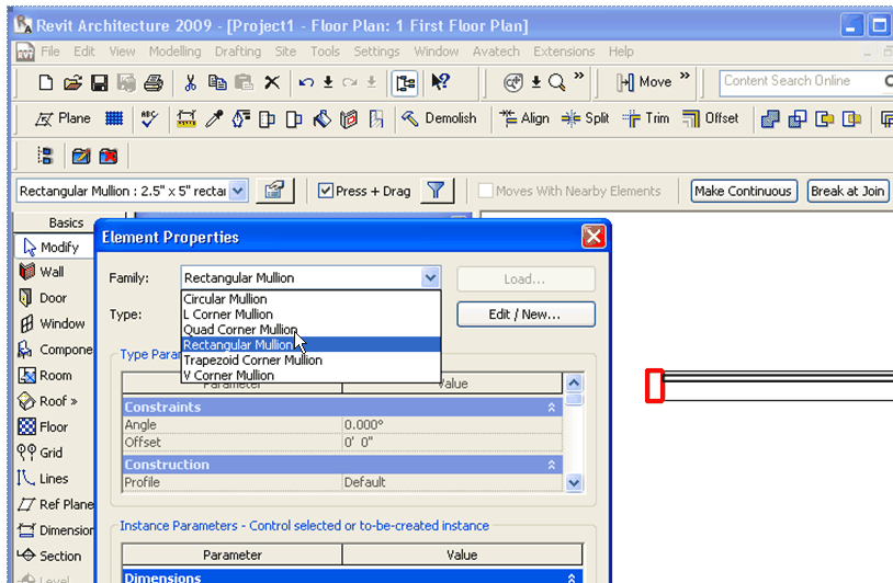

Becca,  I just had to respond to the challenge.  This has not changed.  SEE BELOW - Revit 2009, Revit 2013

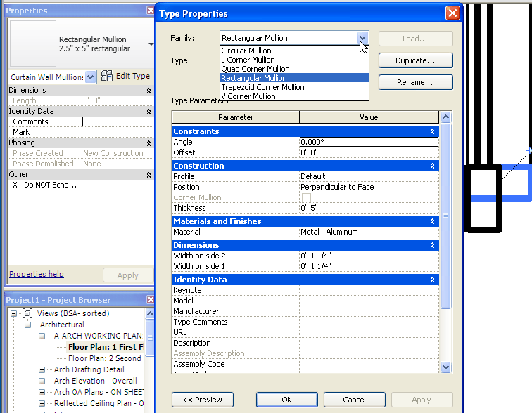

Here is your problem <I Think>... If you clicked on a mullion in a pre-set curtain wall, that mullion is pinned.  You have to un-pin it.  Then you can edit the type, pick the family, round, rectangular, corner, then assign the appropriate profile.

I un-pinned it.  what I am saying is that the family type "rectangular" was all that was available.  the profile type "2.5x2.5" was the only one I could select.  "trapazoid corner" or "L corner" were not available until I did the process I described previously.

Take some time to LOOK at my images!  You can't expect anything more than rectangular when that is the family you are modifying.  DROP DOWN THAT WINDOW AND PICK SOMETHING ELSE!!!!
