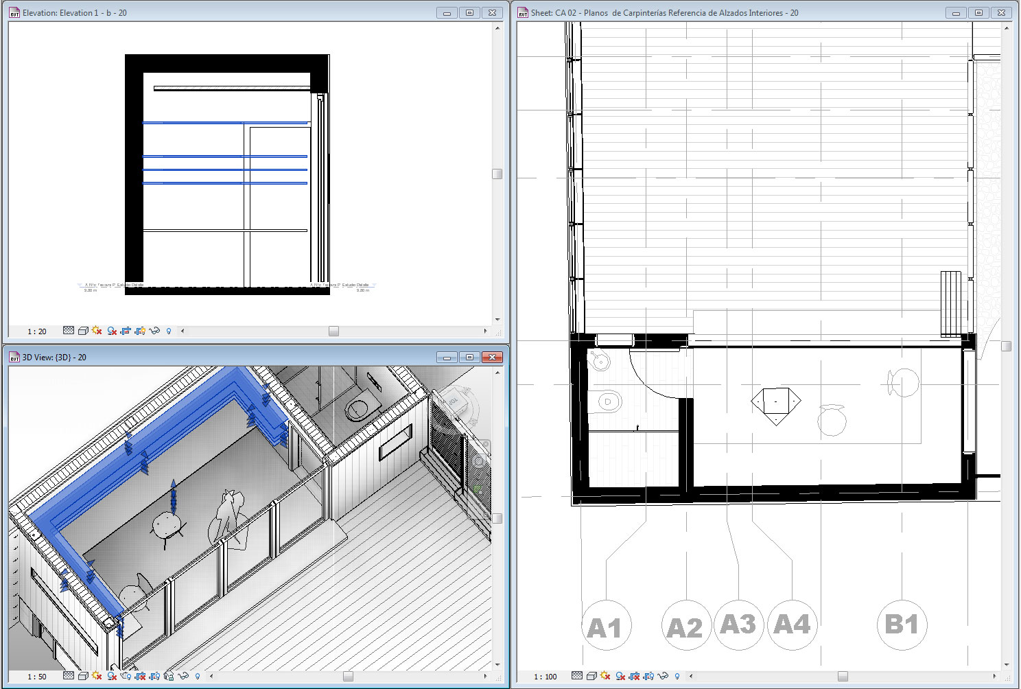

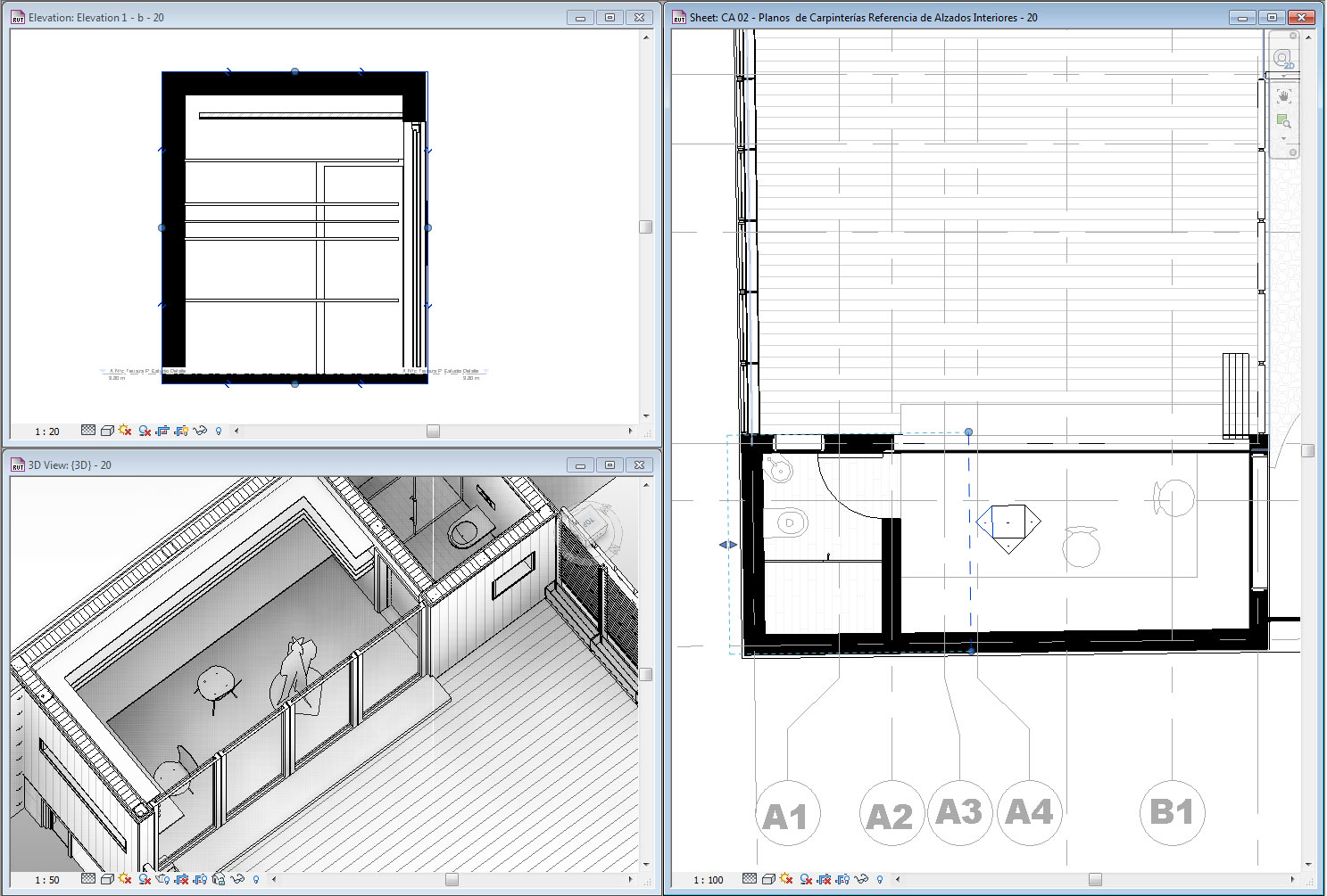

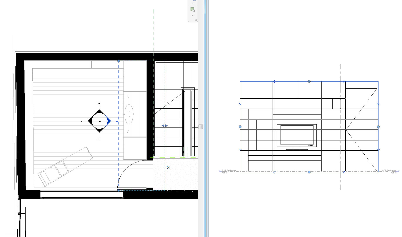

Hello All,
I made a built in place Furniture system, some bookshelves and they seems to work wrong in ALL the model. Even dougth I made them in a second floor they apear at other levels... it seems is a corrupted geometry, or something strange. This bookshelfs dont apear correct at ANY inerior elevation, or  section, they just work fine int theregular 3d view.Does corrupted, or non working properly gemoetry can exisit in Revit?
Should I have to remodel this geometry?
How would I have to do it diferently in order this to not hapen again?
best regards,
PCS
Mon, Jul 30, 2012 at 3:10:15 PM | Corrupted Geometry in Revit? BIG MYSTERY
Your family mneeds to be cuttabe.  Edit the family and set the category to casework.

Thank you tes in deed... furniture is no cutable. THANK YOU.
