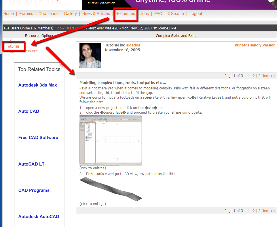

I just looked for and could not find, a technique that I believe elados, proposed which seemed rather involved but which would work good for this item. It was to create a path on a topo. Seemed like he cut out the topo and then I think he exported to CAD, then imported back to Revit as roof, then created edge on roof with gutter, think he was making a path, but edge could be wall or fence. You might try looking there.

This one Steve?

Yes Ty, that is the one I was thinking of, I found in my book finally,
http://www.revitcity.com/tutorials/complex_slabs
Maybe that would be place to start.

I had forgotten this.  Good job steve, Ty and especially eldados...
