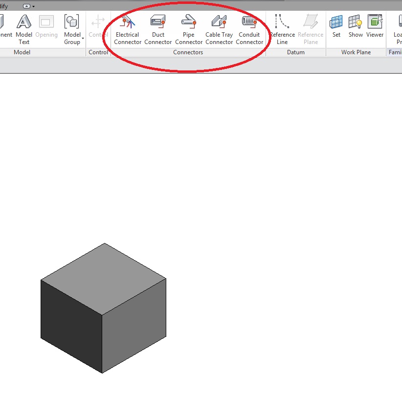

#9
AbsoluteBIM
AbsoluteBIM Avatar
Joined: Fri, Jun 17, 2011
220 Posts
4 Stars: 4 Votes
I've attached an image showing where to add the connections from, then you apply them a face or work plane. You need these to connect into other systems. I don't really know what your modelling here but a refridgerant line would have to have incoming and outgoing water lines, right? so you'd add two connections, and then with the parameters associated with connections, you can parametrically control everything: radius, fixture units, pressure drop, etc. the actually object could just be a box to represent the size and shape.
