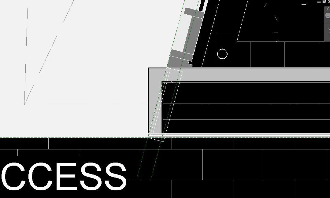

What is the best way to heal the join of the horizontal wall with the diagonal curtain wall which is coming down to meet it in the image?

Create that with "In-Place" Category "Wall"
