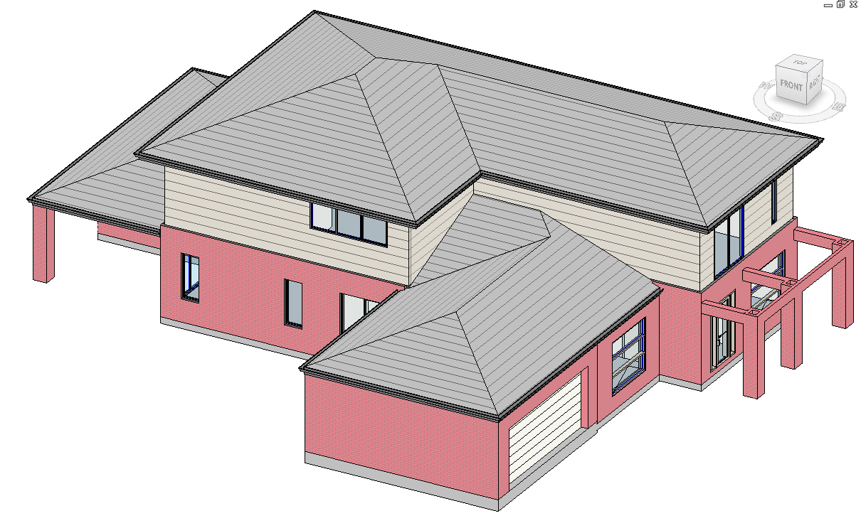

I would like to model the garage roof shown on the attached image using RAC 2012. I can do it
in 2 separate sections - is there a way to model it in one section.
Thanks
Mungo
Sun, Jul 22, 2012 at 5:13:12 AM | Garage Roof
Joined: Tue, May 22, 2007
5921 Posts
4 Stars: 205 Votes
You can't, may I ask you what's the problem to create that in two pieces (two sections)?
You can only have one sketch loop per roof or you can have two BUT one of them must be inside the other to create the "void".

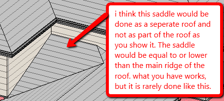

Sun, Jul 22, 2012 at 11:07:08 AM | Garage Roof
coreed
coreed Avatar
Joined: Fri, Feb 10, 2006
1874 Posts
4 Stars: 16 Votes
 See attached image

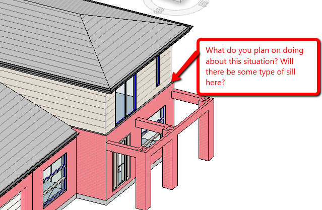

Sun, Jul 22, 2012 at 11:16:50 AM | Garage Roof
coreed
coreed Avatar
1874 Posts
4 Stars: 16 Votes
See attached image

Thanks for your replies Typhoon and Coreed - I will stick with the
2 separate roofs and join them. As for the wall join Coreed it would
be flashed and finished off with a bed of raked mortar - but I wont
model to that amount of detail
