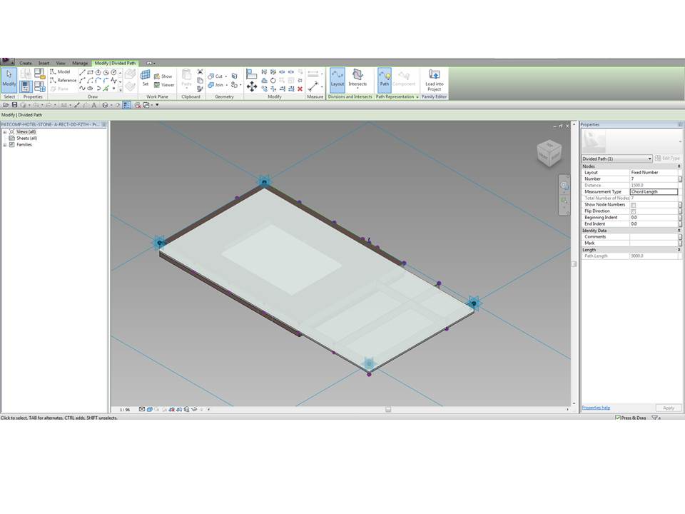

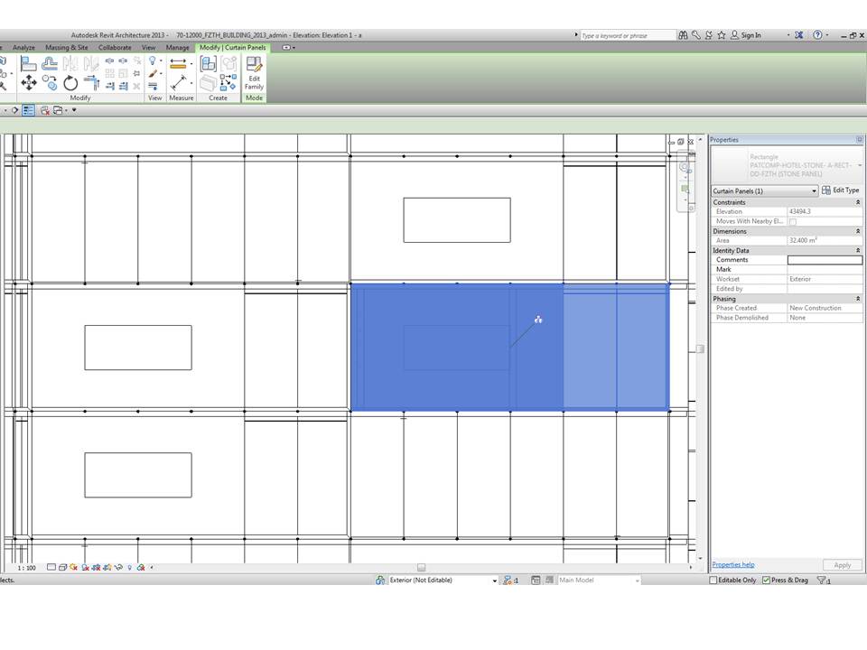

I have a curtain panel that was built with divided path. The panel works perfectly, but the problem is that when I am on my building elevation (on the project file) all the path division points are visible and I cannot seem to find a way to turn them off. I attached 2 images for reference. Does anybody know how to control the visibility of the path division once the Curtain Panel family is loaded into the Project file? Thank you!

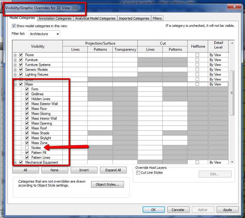

VG > Mass > Nodes

VG > Mass > Nodes works, but in certain conditions. When mass visibility is set to "Show mass by view settings", Mass category is on, and Nodes off. Different settings might keep on showing the points of the divided path.
