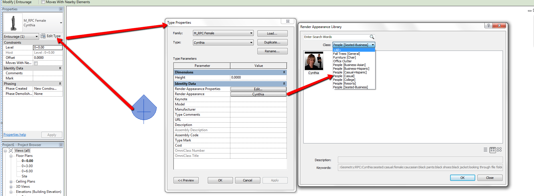

I have downloaded some RPCs but i have no idea how to use them in Revit. Please help

1. Put those RPC's files here:
C: Program files-->Common files-->Autodesk shared-->Materials--> ( Revit version)->Assetlibrary_base.fbm-->RPC's
2. Load into your project any of the default RPC file (RPC - female or male) duplicate it then edit and then you will be                        able to see your new files (see image)
