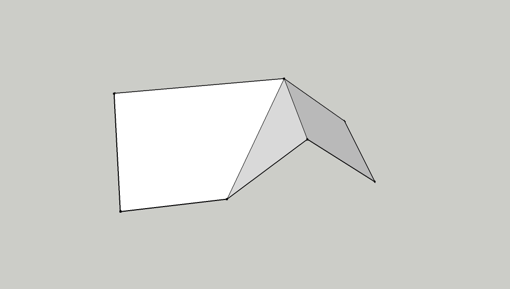

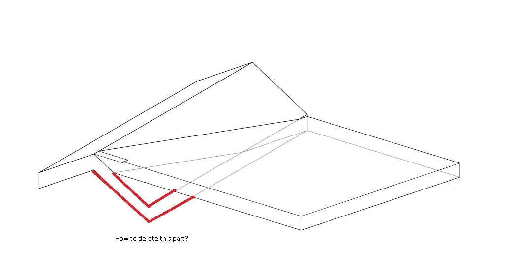

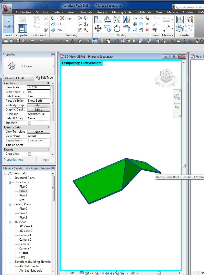

hi to all.
i am using revit and am trying to achieve medium easy roof shape see file what i am trieng to achieve.jpg however with revit it becomes super complicated - problem.jpg i can not get rid of inside roof part - this is done with roof by foot print and then join roofs.

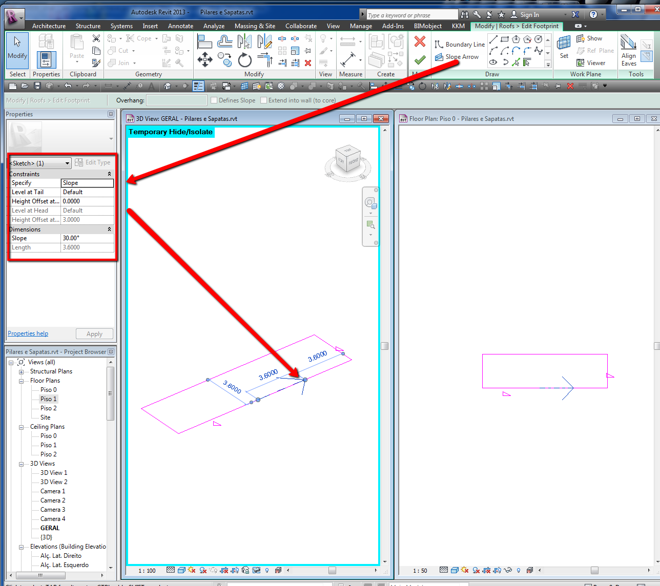

NO NEED TO JOIN OR CUT ANYTHING, CREATE THAT WITH ROOF BY FOOTPRINT IN ONE PIECE, BREAK THE LINE THEN USE THE SLOPE ARROW LIKE YOU CAN SEE ATTACHED...
ohhh, sorry for CAPS on, i'm working...
