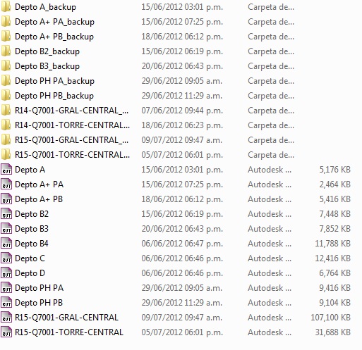

At our office we have a three identical towers of 16 stories each, with 50 apartments each.
We have a central archive with all the exterior areas and parking lot, with one link for the tower and two copies for the other two.
Also, the linked tower has all the 7 type apartments nested in more linked files.
With this we have someting like an inseption: departments linked into tower and tower linked into the central file.
We work marbelous, because we have worksets for everything and we can be able to turn off tower 1, tower 2 or tower 3 worksets, and also department a, b, c, etc. and also we have worksets for the exterior area.

Hi. I am attaching a print screen with all the files. The most heavy is the main file, with 100 MB, the others are quite less heavier..
All the info is detailed with annotations and detail callouts, etc, on the main file only... this is what we are doing also for the tower, so this files are floating 3d views without anything more than walls and floors, with their correspondant furniture.

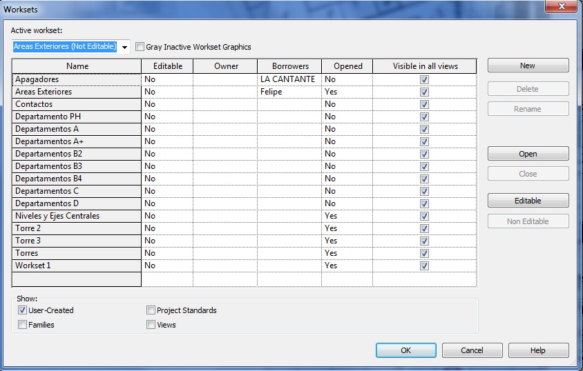

This is the list of our worksets...
I have worked on projects with 200 and 300MB but without linked files and with only the two default worksets, and those files export views and print smoothly and much more faster that this one.
I feel that Revit goes crazy when you work on linked files, more that with worksets... It's been generally accepted that linked files helps to have less KB on your file and to have instances instead of copied items on a single file. But why do we want to work this way if everything tends to be trapped on the main file and printing/export becomes an slow-motion-time-consuming picture reducing my lifespan while I watch the screen and do nothing?

These are really small files for the problems you are having on a 24 gig system.  We had a 250 meg main file with linked structural and mech files on a 2008 Revit - 3 gig, 32bit system and although slow, we were able to do that.
Again, although it is late you may learn something here.  I don't believe there was any advantage in separate files since you annotated in the main file.  The model elements could have/should have been in the main file and on the separate worksets you were using.  Then you could have used reduced worksets while working.  That would have accomplished the same advantages you were trying to achieve.  I have not worked in the manner you are using but this heavy linking may be part of your problem.
When we printed on that 2008 large file, we organized our printing so that we only had on the other linked files when we needed them.  Otherwise, we unloaded those links.

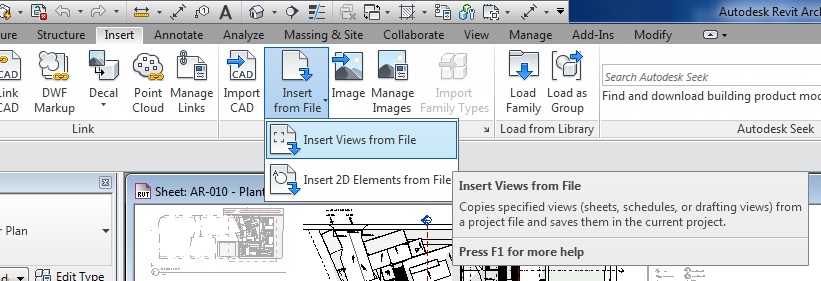

So basically what you are suggesting is to do the next steps:
-Give bind to the apartments so they will be directly on the tower.
-make all the sheets-related-to-the-tower on the tower file.
It is not to late fot doing this, because we have like 6 months with the project there is a tool called "insert view from file", so I can migrate the views to the tower file, and it wont be so much trouble if it solves the slowness of the exporting/printing, many of this views are only placed on sheets because we started with exterior elements in the main project so they exist but they are "clean".
Also it may be an advantage because the teamwork can be working on two different files, and the printing process will logically be faster.
Thank you so much, I will give it a try.
