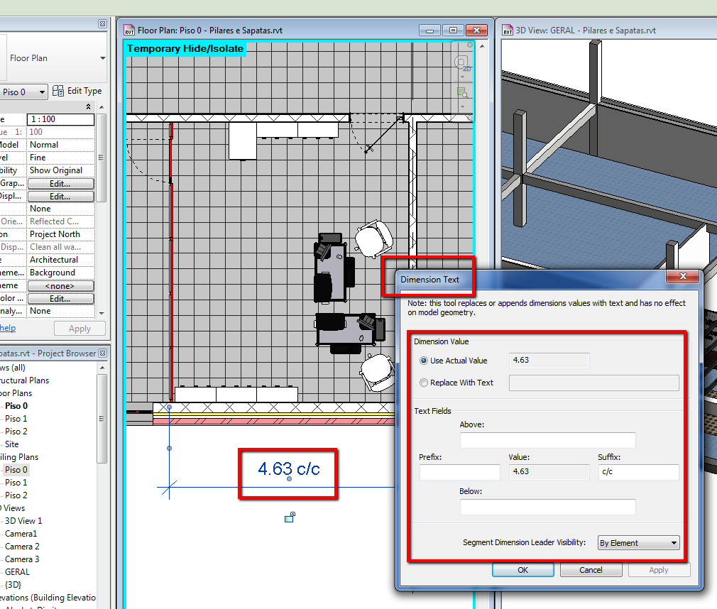

In dimension of Autocad,  text are stacked and set suffix/prifix  in dimension style.
In Revit Architectureal 2012  ........any solution ?
see attached image

Double click your dim text
Mon, Jul 9, 2012 at 7:01:38 AM | text stacked and suffix in dimension style_ possible?
Fractions will not stack in Revit yet....

@ Typhoon,  by double click dim text, one instance of text is override (just like instance parameter)
i want to add suffix in type parameter ( like type parameter)
any solution ?
