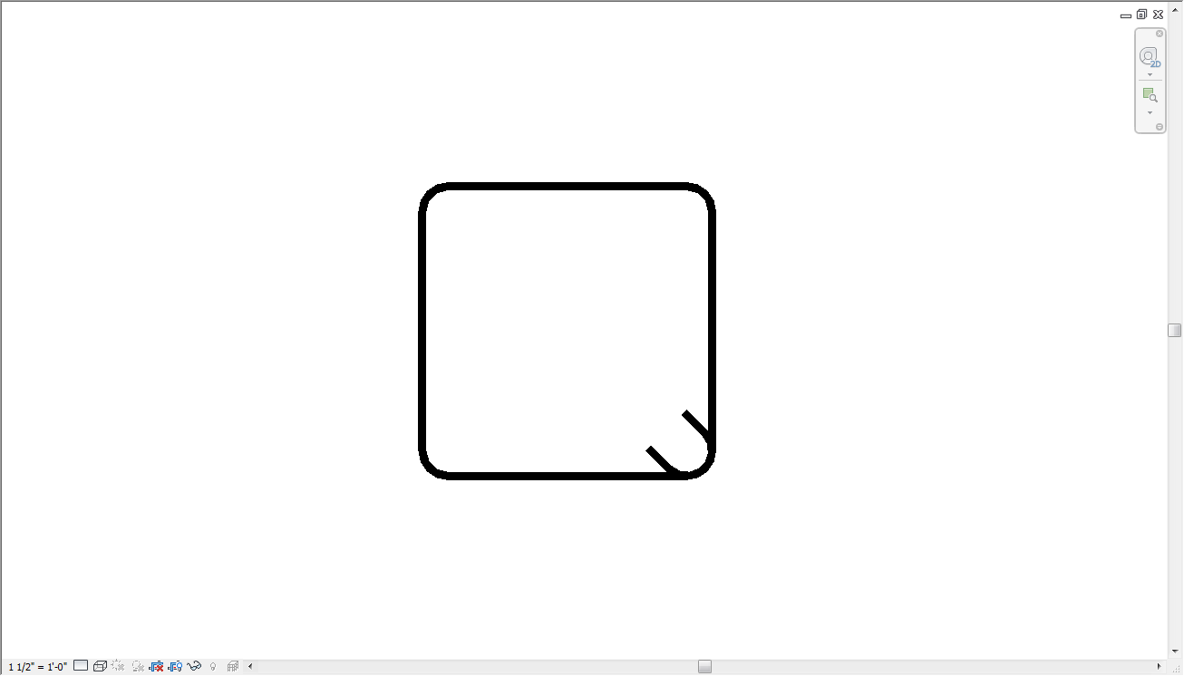

does anyone know how to get strirrups with tie drawn in a detailed drafting view? i am attempting to draw a list of details in the drafting view and i can only use the Bar Section and Bar Bends........but there is no family where i can use Styrups under detail family with a tie..........does anyone know how and where i can get it to be used in a drafting view?

In Revit you are encouraged to make things, Families, attached is detail component rebar tie #4 you can modify these things.

thanks....i just drew it using fill region since i dont have to use it as a family. i will be using it as details so once i draw it, i dont have to change it. which means that i do not need it to be a family due to the fact that i can copy drafting views/ import them from one drawing to the next.
thanks for that file....i was trying to make one myself but i dont need it again since i figured out that alternative way.

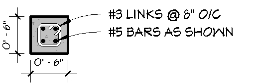

sometimes I just use a linetype for reinforcing.
