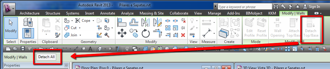

How can I detach a WALL from an unknown object.
http://screencast.com/t/EwfqcVxhK
http://content.screencast.com/users/zuzullo/folders/Jing/media/57ea14d0-5530-41b8-a8d8-0c524c6f2348/2012-07-06_2244.png
Do you wanna SKYPE Revit? Its quicker Smile

Don't you have that wall Attatched to a ref. plane?
Select the wall, select "Detach Top/Base" then "Detach all".
