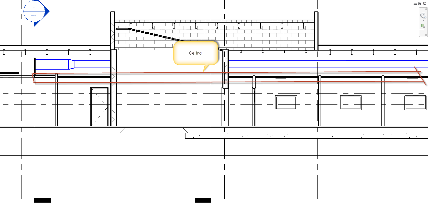

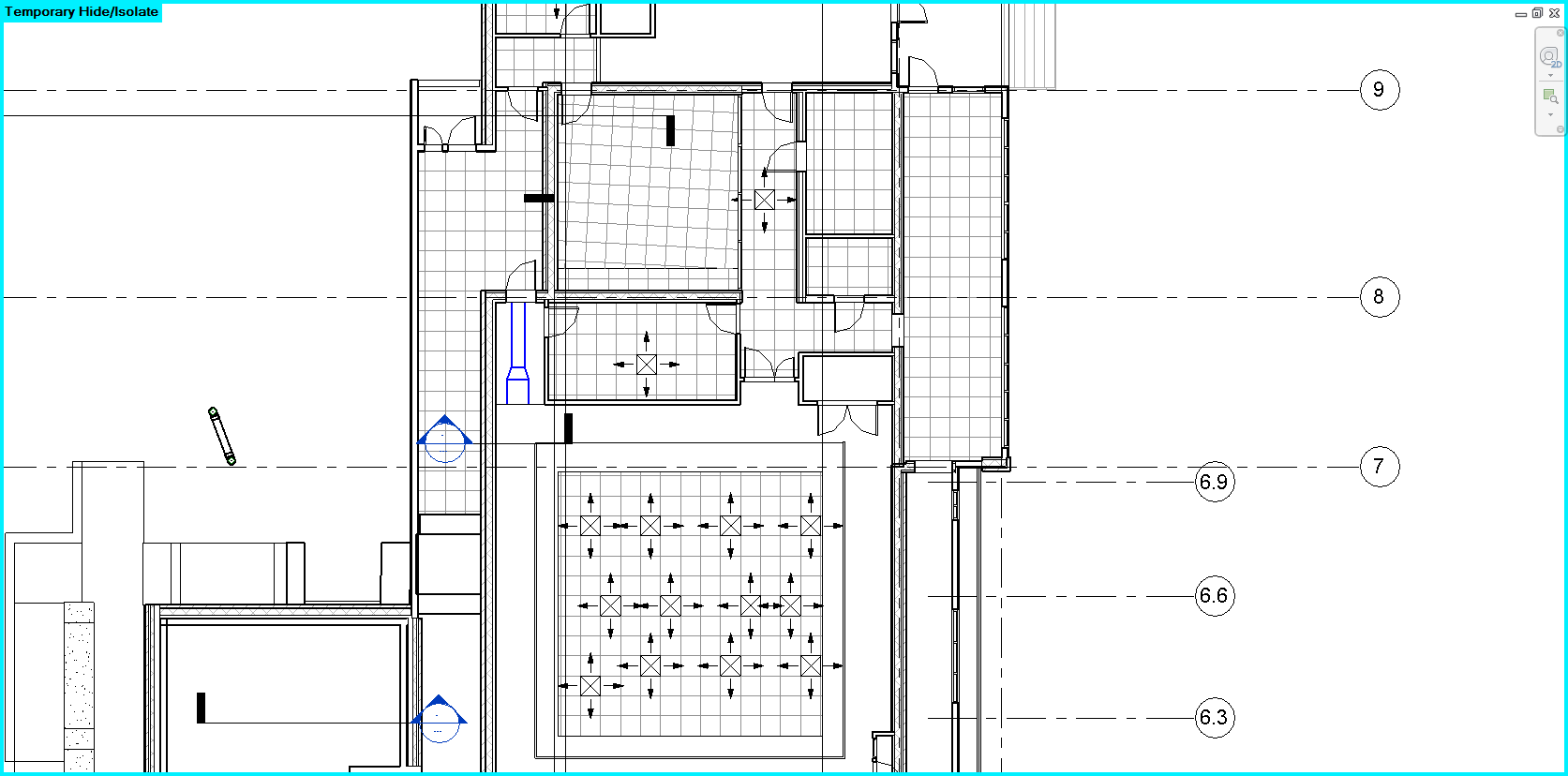

How come my ducts are hiding below the ceilings even though I clearly have them above the ceilings. See pictures attached.

this is what happens when you use a ceiling plan with duct work. we have to use floor plans so everything shows nicely.
