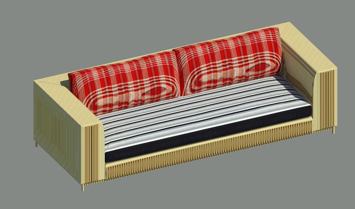

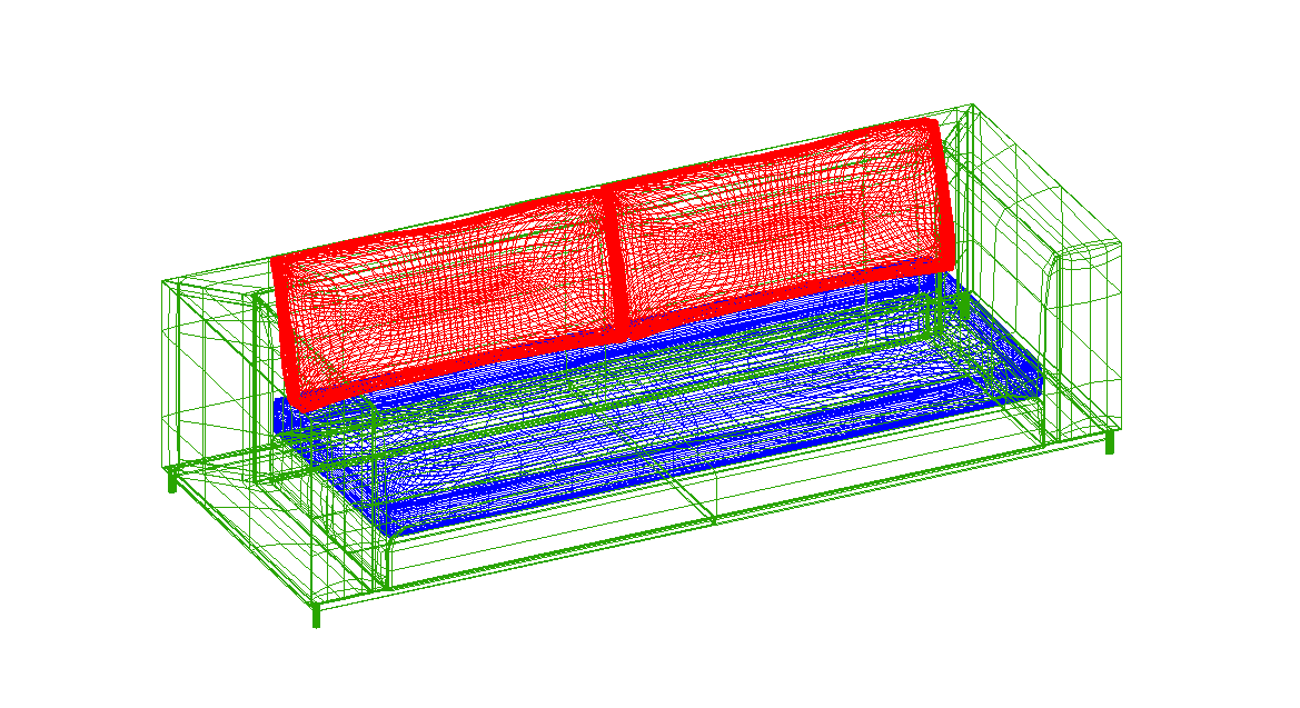

Hello,
I have a big question about dwg files turn into revit family's.
I've downloaded some furniture from a manufacture designer, but the files are all in dwg or 3ds, and i want to make furniture family's in revit with those files.
I did the family and all the process that have to be done. Metric furniture -> insert cad etc etc....
But when i render, the materials go crazy on the model.
Can someone help me? is there something that i must do in dwg before importing to revit?
In this post there are 2 pictures of the dwg file and the render in revit.
I would appreciate your help
Thank you, Canhatelier

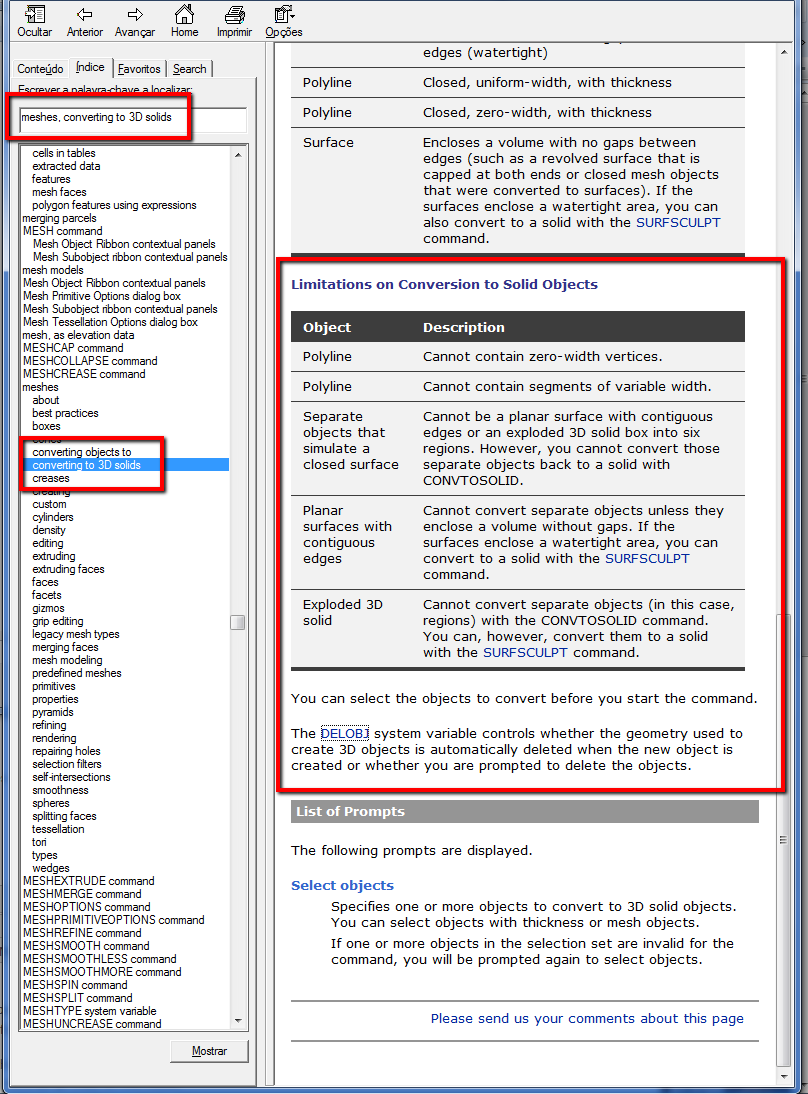

The issue is they are not 3D solids, they are 3d faces (mesh), I don't know if this gonna work but you need to convert those objects in Solids, use the CONVERTTOSOLID or SURFSCULPT in CAD to convert those mesh...
You have some "limitations" to follow, watch the image....

I've tried the surfsculpt and gives me this: "Select surfaces or solids to sculpt into a solid:  1 was filtered out"
When i try the other command convtosolid : "Object cannot be converted."
Can you see the file and give it a try? If the problem is how the sofa was made in 3D or if i'm doing something wrong to turn it to a solid.
Many thanks, Canhatelier

The file you posted is already 3D faces as we can see in the first image.  All you have to do is assign the material you want to the appropriate layers.
If this import did not have faces, then it would not render but yours did.  Patterned materials on complex shapes may not render well on faceted objects so good-luck with that.  If these are your materials, then you may not get it like you want it.
I believe Typhoon's post would solve the render problems because it would get rid of the facets and you don't need to create new ones.  Just edit the file per Typhoons instructions.
