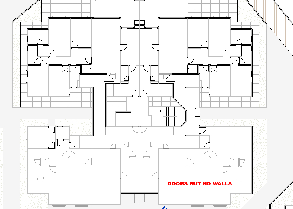

Hi everyone, I am relatively new to Revit and so far just following the forum was enough BUT i've encontered a problem that I can't fix it. I am working on a project of a small housing building and the underlay is giving me headaches. I am working with groups because the building repeat itself in the projetc so any modifications would be easy to do.
So here is the problem, it doesnt matter the view, when I turn the underlay on it shows doors and some walls...that's it. The rest of the projetc I cannot see. I've tried to change the view range settings but it doesn't work.
Any ideas?
ps: working with revit 2011

And in that view did you change the "Discipline"?
Can you post some images with the "properties" of that view so we can see the problem?

Nope...the discipline is set to architectural. I am sending an image for ou guys to see.

And those "missing" walls and doors are from the same level?

Yep...they are from the same "upper" level.

Are you using Phases or Worksets??
Change the "View Depth" to "Unlimited"
Those doors are like in "Halftone" mode, did you override those elements?
Did you create any filter and apply to those elements?

Sorry Typhoon, I dont know what phases and worksets are, if has something related to linking the file with another one the answer is no. I am not linking it to anything. I've changed it to unlimited but it didnt work. And I did change those doors from what they were. I mean, they were doors but I changed the family a little bit.
