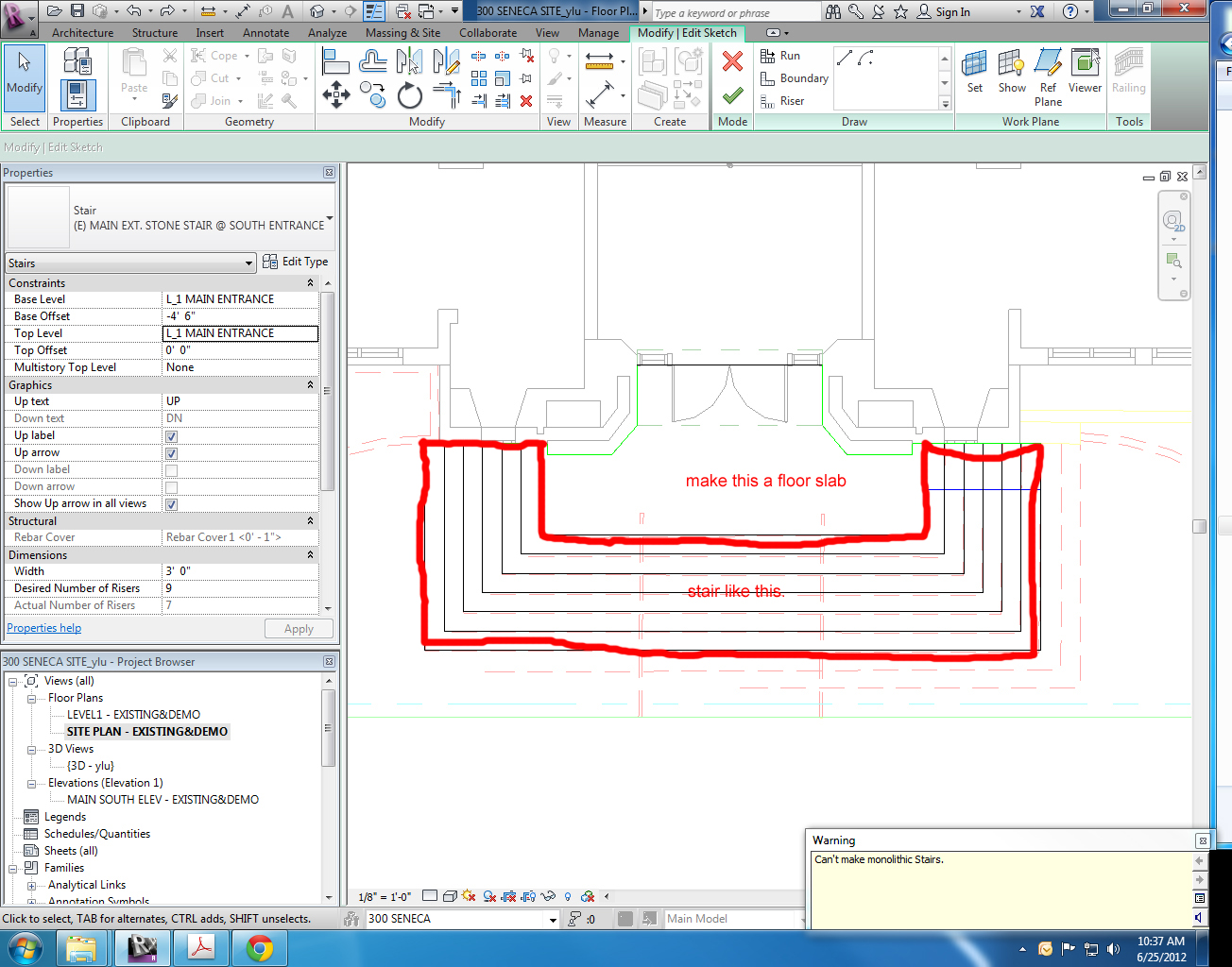

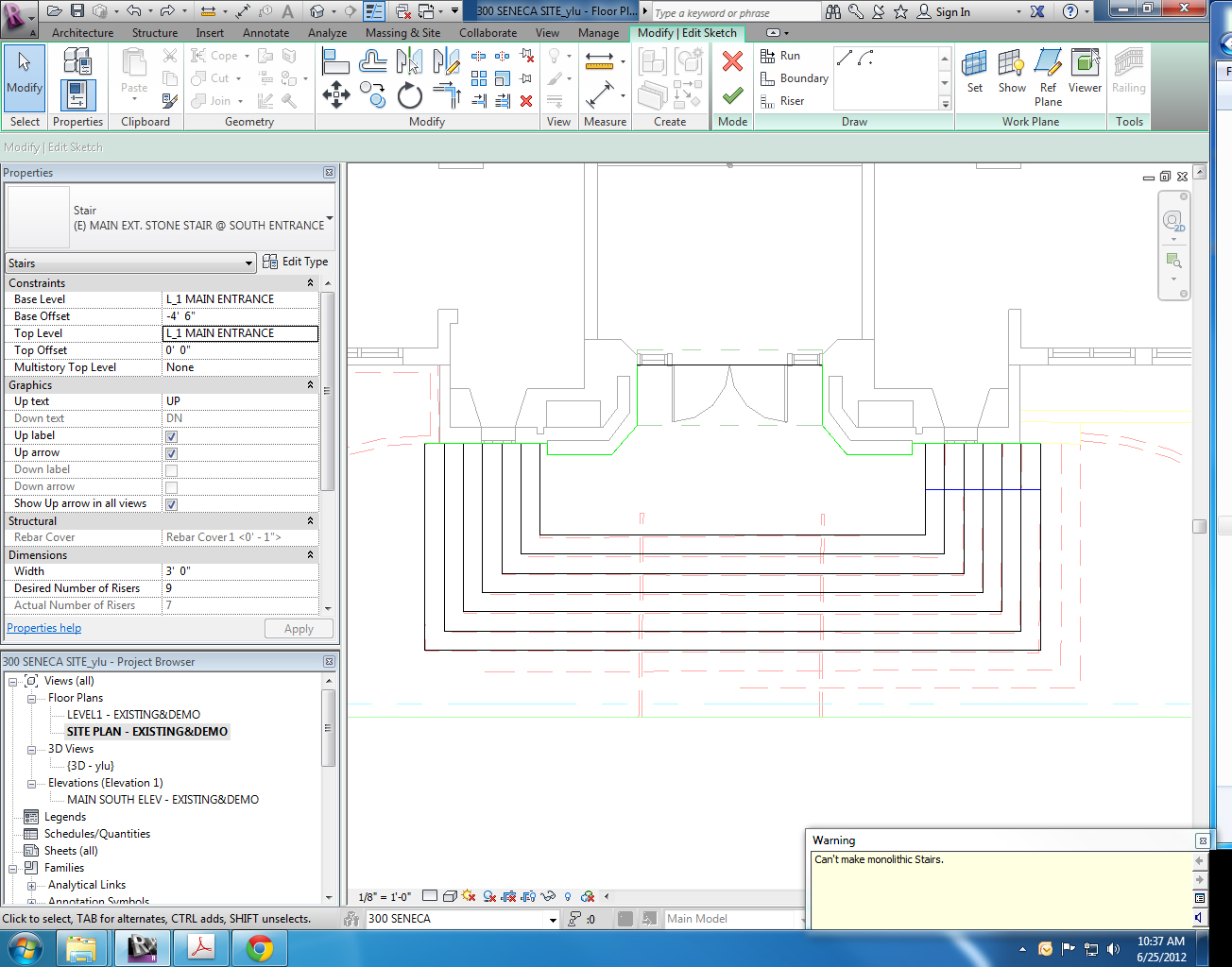

I'm trying to make a monolithic stair of an odd shape (image attached) but I keep getting an error "can't make monolithic stair".  Can someone take a look and let me know what I am doing wrong?

I would get rid of the last riser at the door and the whole landing.  Just do the U.

Wont' let me do that either

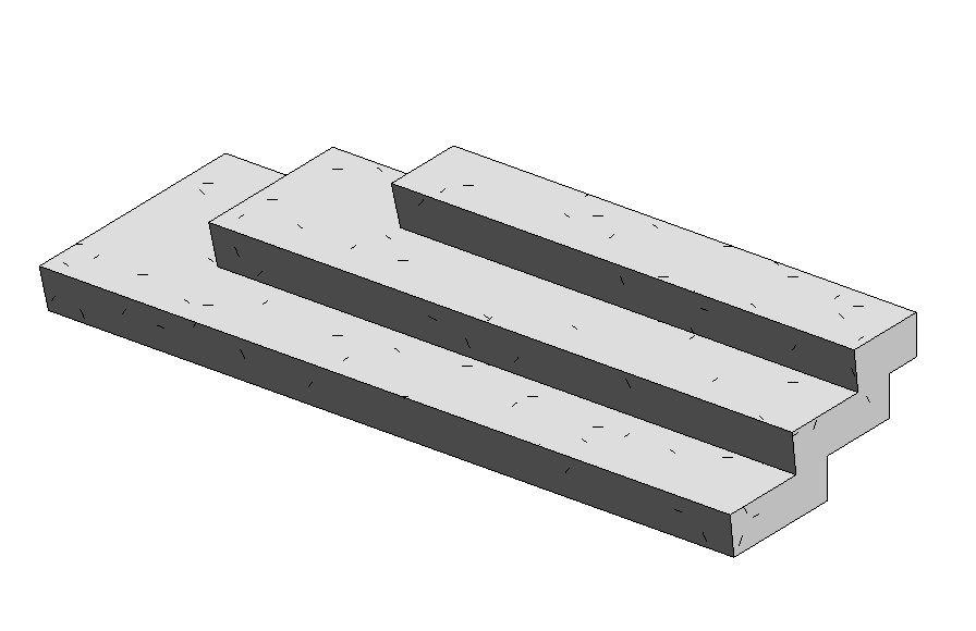

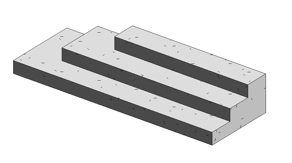

No need to In-place, to create that in one piece there is a trick: just put the riser height in "Tread thickness", it's not perfect but will work OR create that with 3 stairs.

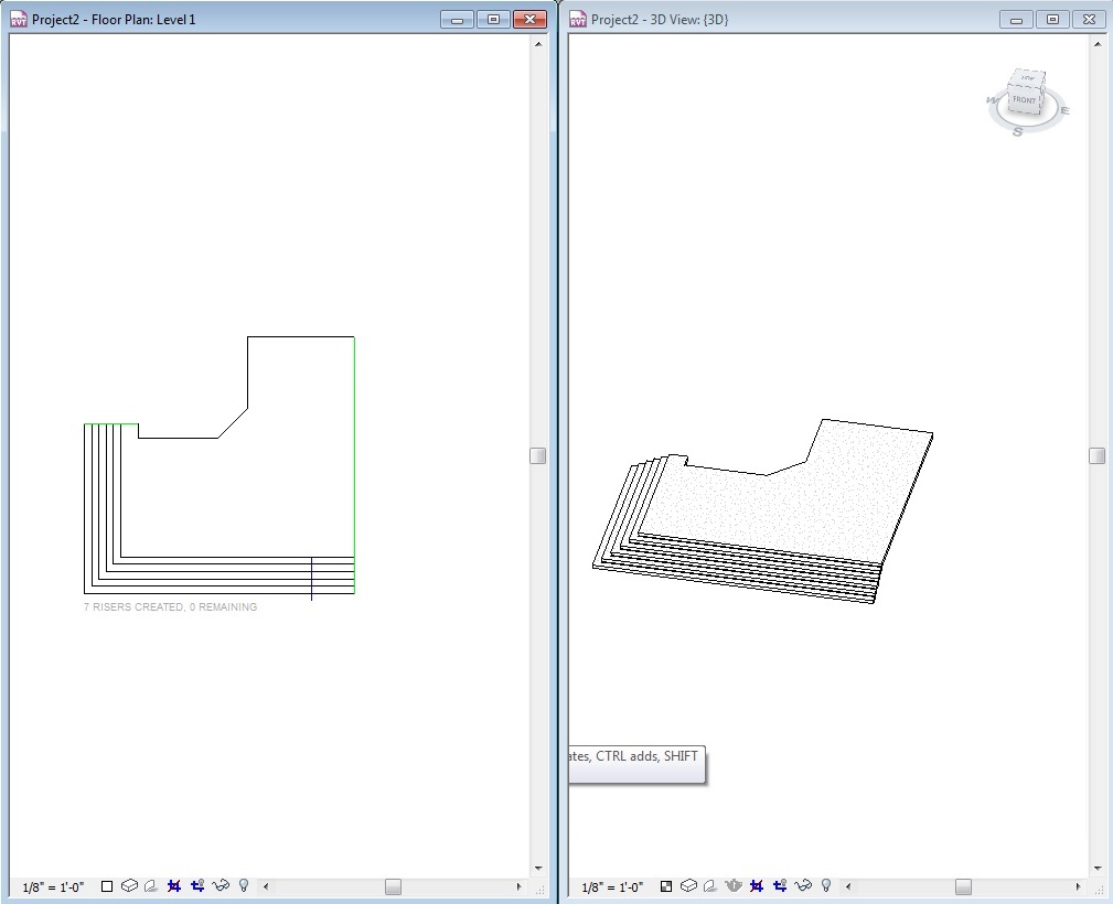

Create half stair and mirror it as shown in the image. Also select stepped in the underside of the winder in the type properties.

do it like this

Although floor slab would work in plan and 3D, I think it is a poor solution.  The best is using stairs but in this case, Revid does have some problems with the monolithic stair type.  If the 'U' shape without landing did not work, then RevitIndia's solution would be better and I know that would work.

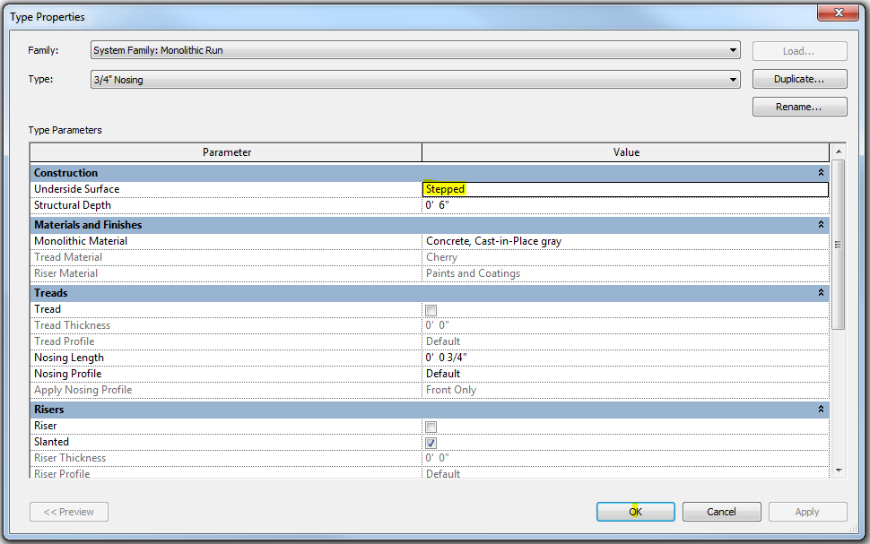

This may have been updated in 2014 (which I am using right now), but if you edit the properties of the Monolithic Stair - Run Type - Underside Surface to be Stepped, instead of Sloped, it will work.
But make sure that the Structural Depth is not greater than or equal to the total of tread depth plus nosing length (unless nosing length is 0", then you can set it to whatever depth you want, if you want stairs to appear as solid block of concrete).
