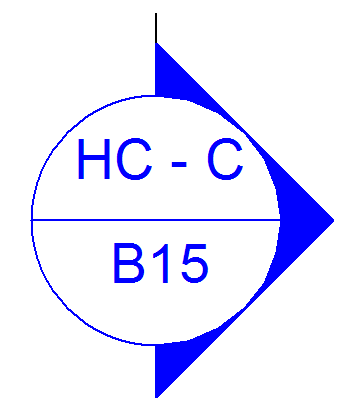

I would like to show the section heads in my Roof Layout, however I cannot find them anywhere.
  • They are not hidden
  • They have no overrides applied to them
  • They are currently showing up in all other floor plans except this one
I have researched this issue for approximately a year and still have not found a solution.
Any help would be appreciated.
Thanks in advance.

Post some images to clarify the issue

Typhoon - I have attached an image of our section head here.
WWHub - I tried what you suggested about the section cuts, etc, and they were all set at the correct levels. However when you mentioned about changing the scale to the same as the floor plan they did show up.
dgcad - Additionally to what WWHub was saying, it was the "Hide at Scales Larger than" which solved our problem.  Our floor plans, reflected ceiling, slab plans, etc were all set at 1:100, however our roof plan was 1:200. We were unaware of this setting in the properties box, so regardless, thankyou for making us aware of that.  We've learnt something which we can use in future projects.
