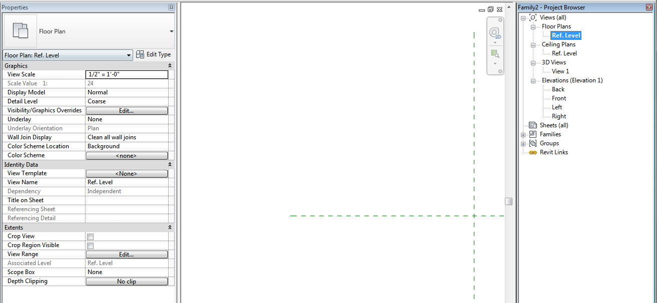

Sorry, I'm still not following. When I click on the view in the project browser, all that shows up under properties is a drop down for "Default View Template" and there are none selectable...please see picture.

Sorry I did not realize that you are in 2012.  I know that you can do it in a family in 2013 but I don't believe that you can do it in 2012 unless I too am missing something.
