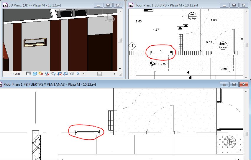

HELP!...I'm trying to place a window (80x30cms) on a wall, but when i do the wall disappears leaving only doors and windows visible on this wall!! this only happens on my door/window floor plan. I've tried a few things:
  • checked my plan region and it seems fine, since other included walls are behaving normally.
  • I've also applied a different view template from another plan but did not work.
  • this wall has split-faces but deleting them makes no difference.
  • Only when I make the window bigger, the wall reappears. but that's no good since i need a smaller window :/
I've attached a screen capture to illustrate this issue...has anyone come across issue????

Maybe a corruption issue / many be a video card issue.  Duplicate the view and see if it is all there.

WWhub, i've tried duplicating it but nothing changes. every other plan is displaing this wall normally except for this particular floor plan...

changed graphics settings...no luck.
Mon, Jun 18, 2012 at 3:08:56 PM | wall disappears when placing window!!!
OK... Now create a new plan - not duplicating.  GOTO View Tab / Plan Views - uncheck the "do not duplicate" box and create a new floor plan for that level.

YEP THAT WORKS, GUESS I'LL HAVE TO REDO THIS FLOOR PLAN. GOOD THING ITS NOT COMPLEX. YOU THINK ITS A BUG?
Mon, Jun 18, 2012 at 4:07:41 PM | wall disappears when placing window!!!
You don't have to redo anything.  Window the entire plan and use your filter to remove all model elements from the selection set, then copy to clipboard and paste same place in your new plan - done.
I think you changed something in your old plan.  Probably hid that wall.

I'LL TRY TO THINK OF THAT NEXT TIME, ALREADY REDID EVERYTHING  :D. I'LL STILL TRY YOUR METHOD THOUGH JUST FOR CONFIRMATION PURPOSES. THANX

Just use 'cut' & 'paste aligned to same place' on the window - this normally sorts this issue out for me
