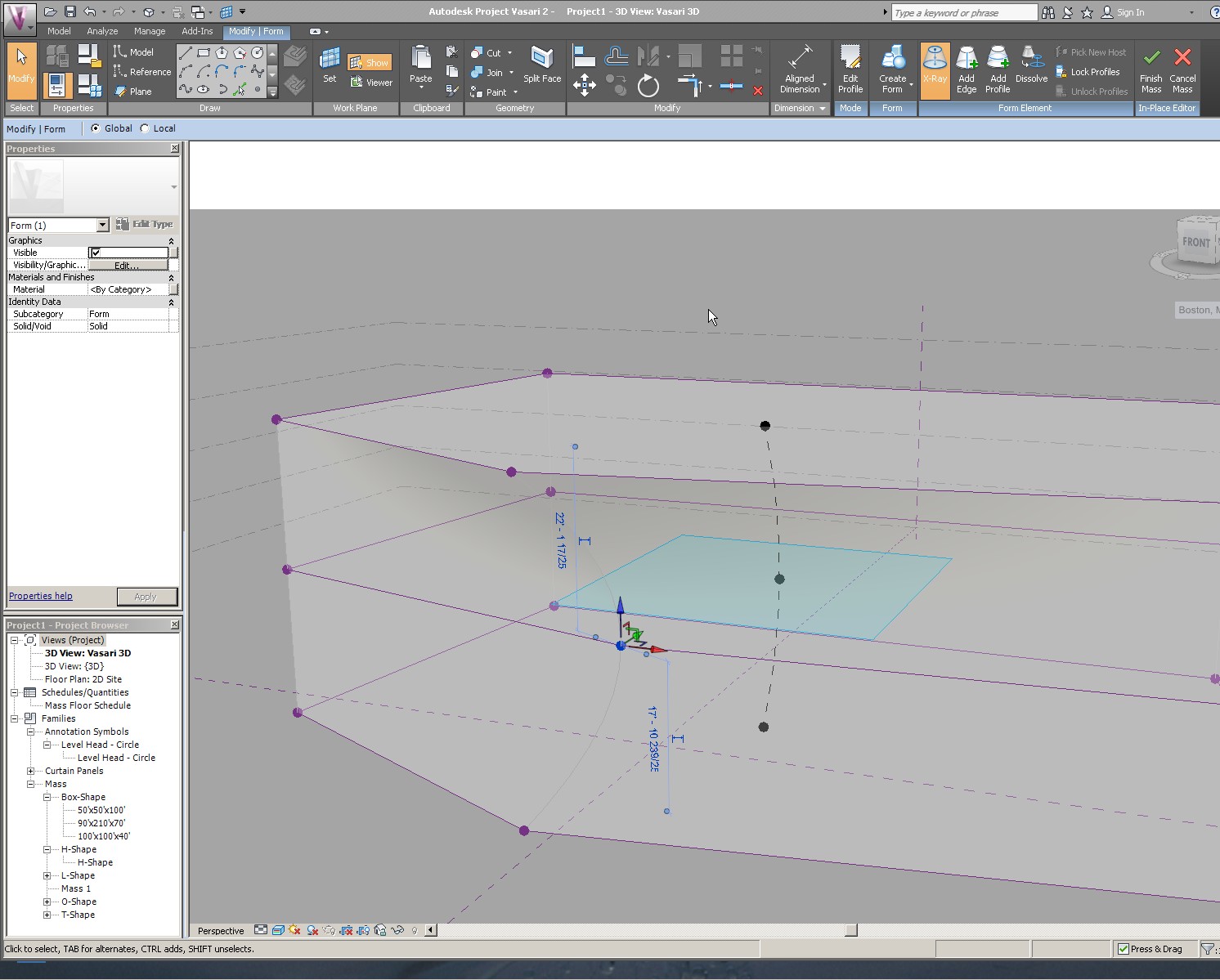

How can I edit a point of a profile and have only straight lines?
See pic bellow:

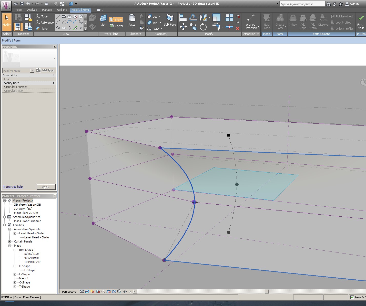

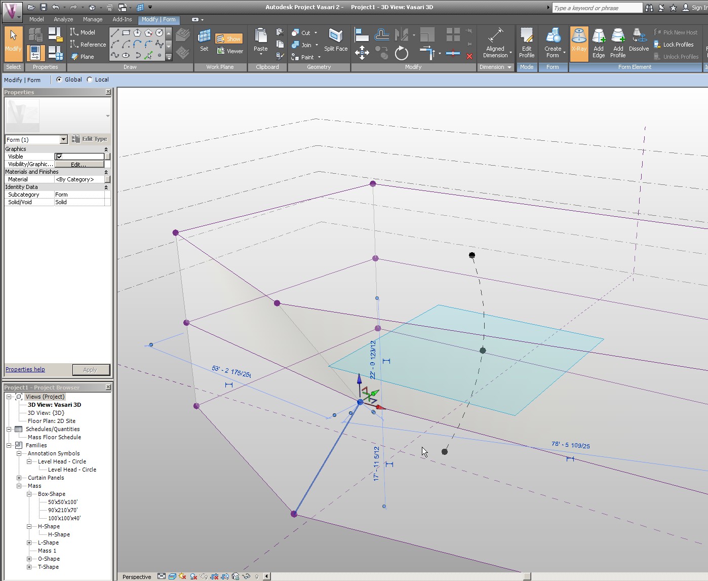

Select the curve then click on "Add Edge", now select the points to create a straight edge instead of a curve

ok, what am I doing wrong?
Made a 60sec video if you dont mind checking my process Smile

I can't see your video... firewall but it's the same process in Vasari or Revit, Select the curve then click on "Add Edge", now select one point then the other. done.

Wierd, don't work in mass, only vasari... Whatever... just dissolve the mass and create again with 3 profiles. Done

Dissolve then select the bottom and the middle profile and create mass, now select the middle and the top profile and you will have the final mass.
