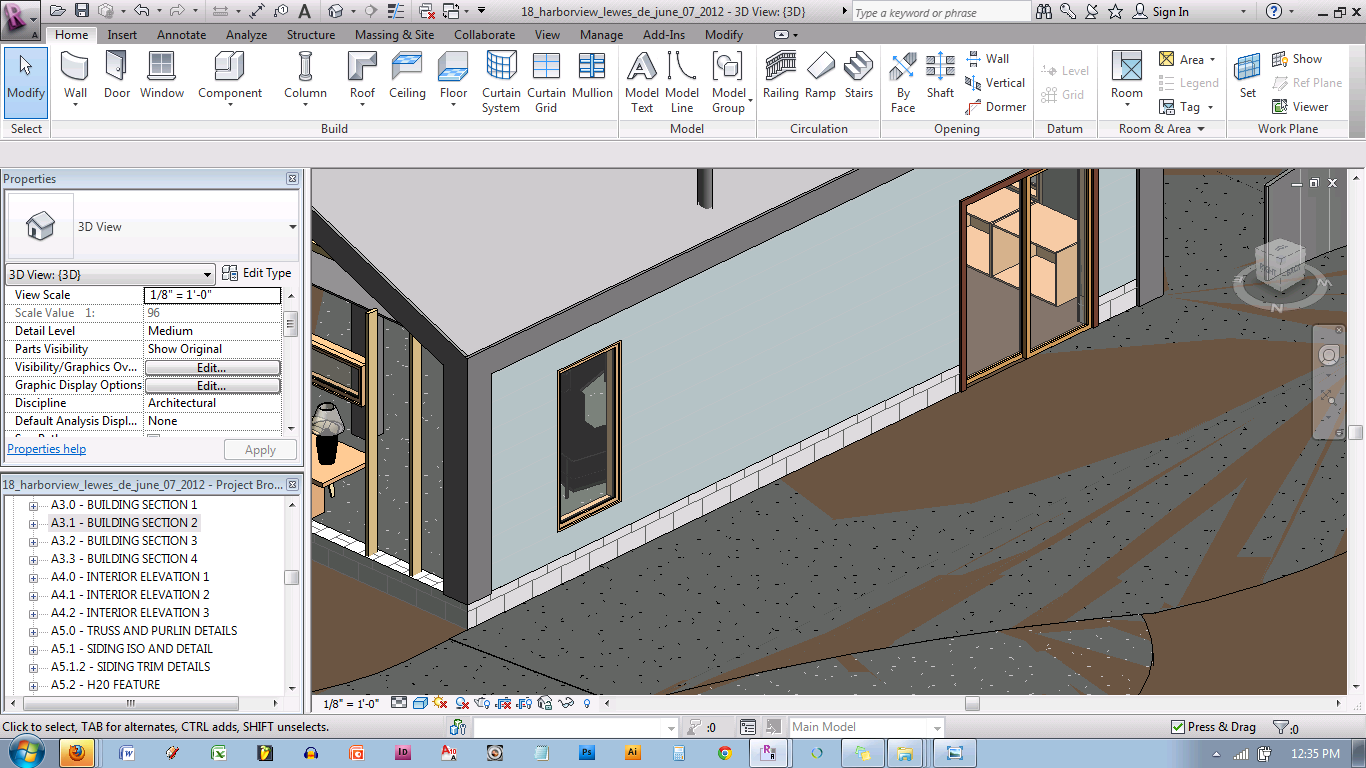

1.) The project is a garage renovation.
2.) It has a C.M.U. footing/retaining wall and I would like to overlap that footing/retaining wall with the siding from the wal.
3.) I currently have it drawn as only an offset "retaining wall"
Please refer to the attached image. Any suggestions?
Tue, Jun 12, 2012 at 12:36:43 PM | Overlap Exterior Siding Over Garage C.M.U. Footing...
Edit your wall and unlock the siding layer, then pull that layer down in section views.
Read your HELP on wall definitions if you don't understand.

In you wall type properties edit structure, switch your view to section, under Modify Vertical Structure click MODIFY, zoom in to the bottom of you wall and click on the line that represents your siding and unlock the lock button.  Once you do that you will be able to drag your siding past your C.M.U.

Thank you both very much for your time and help!
