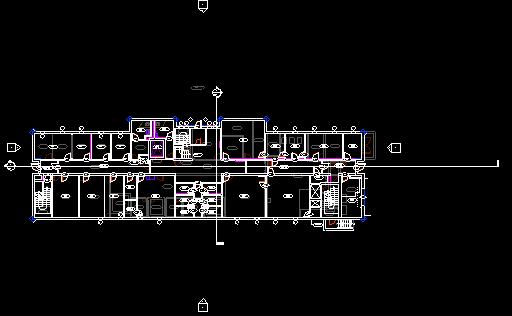

hi all, and thank you in advance. i have received an architectural model from a client. when i opened it up in Revit 2013 i noticed that even though the settings for the view range are setup correctly. TOP: associated level Offest 7'6", CUT PLANE: associated level Offset 4'0" and the other 2 are set to associated level with 0 offset. the only level that looks right is the basement. the upper levels show the walls from the level below. they are halftone, but still show and are selectable. i can't figure out how to fix this.

In that view change the "Underlay".

thank you, that worked when i set it to none. i knew it had to be something easy, i just never had that happen before.
