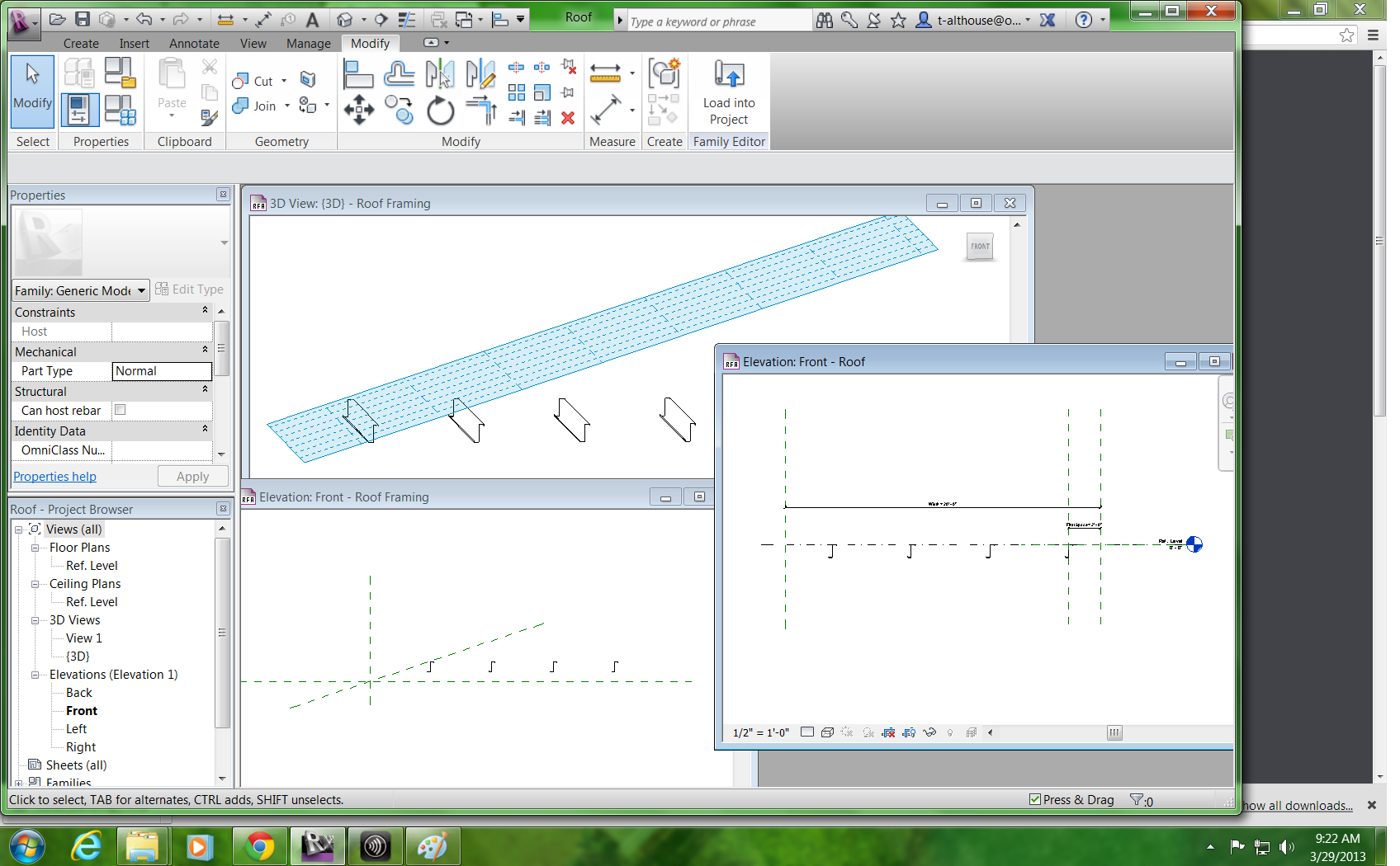

I am trying to nest a parametric set of purlins into something similar to this, so that when I draw my roof, all detail components embed as well. I am having trouble, however, trying to align the nested purlin structure into a roof structure, as I can seem to get them to go at an angle. I attached a picture of what I am looking at. Thanks.

Detail components are 2d.  Use model components.  They will cut correctly.

Am I missing something? I didn't know I used any detail components...I inserted my purlin model, other than that I am not sure what you are talking about "detail components"

Sorry, I read this "...all detail components embed as well...".  That mislead me.
I'm not sure what you are asking and what you are doing. Perhaps this family will help you:
Roof Framing For Sloped Roof
