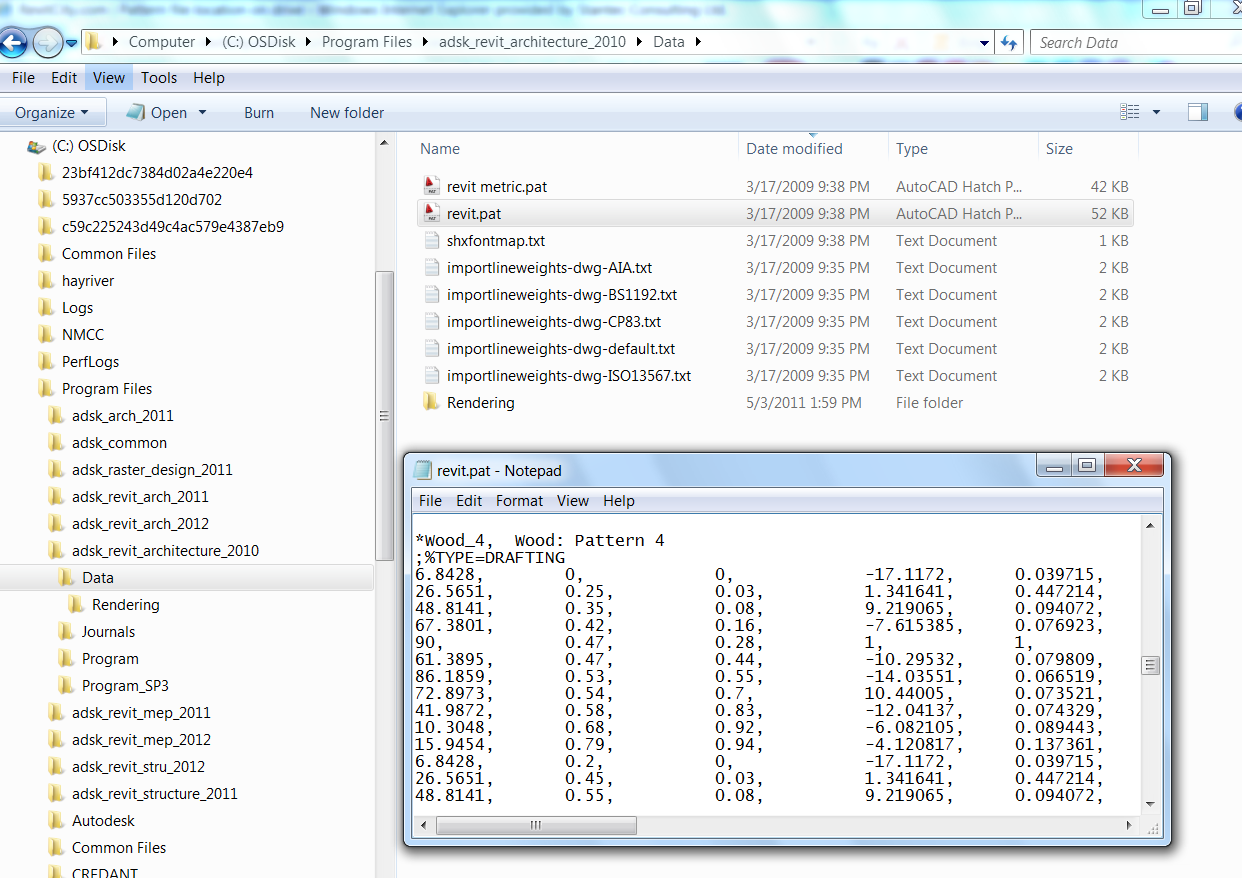

Your fill pattern code needs to be cut and pasted / incorporated into the *.pat file located in the c:\program files\ folder.
See attached image.

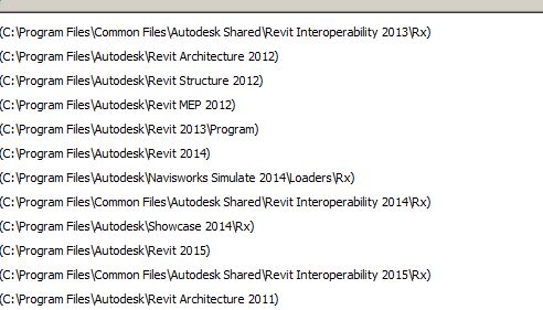

Just so everyone knows, the location of this file has changed with almost every version of Revit.  Attached image shows some of the locations.
