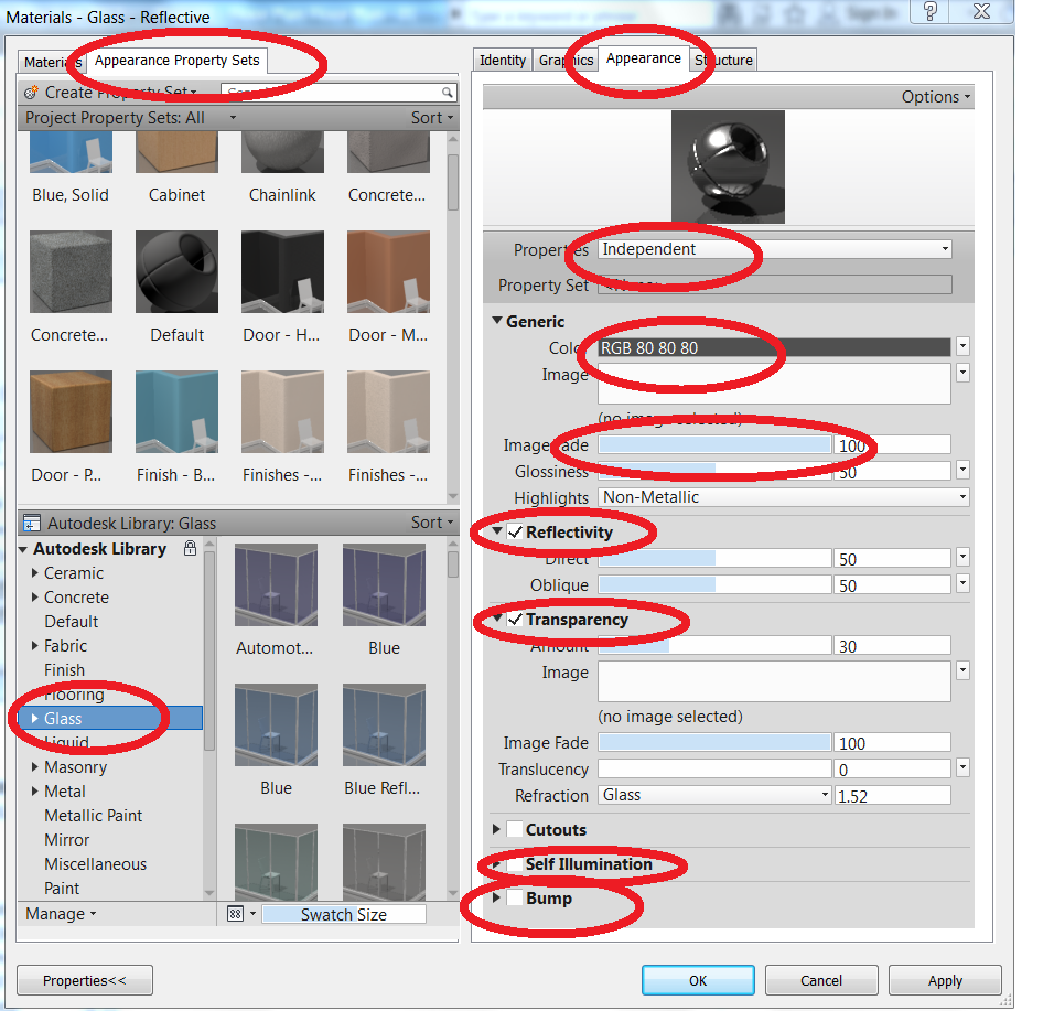

OK, I understood how to create these two materials and I know how to assign them but what are the right options to set up so the glass of one of the types to be with light transperency effect. What I mean - not complete mirror but with some ability to look true it like a real glass window?

Change the REFLECTANCE and TRANSPARENCY settings in the Material Editior
Fri, Jun 8, 2012 at 10:03:27 AM | Rendering - glass?!
dgcad
dgcad Avatar
Joined: Thu, Mar 17, 2005
1231 Posts
3.5 Stars: 36 Votes
See attached image. The options are in the material editor.

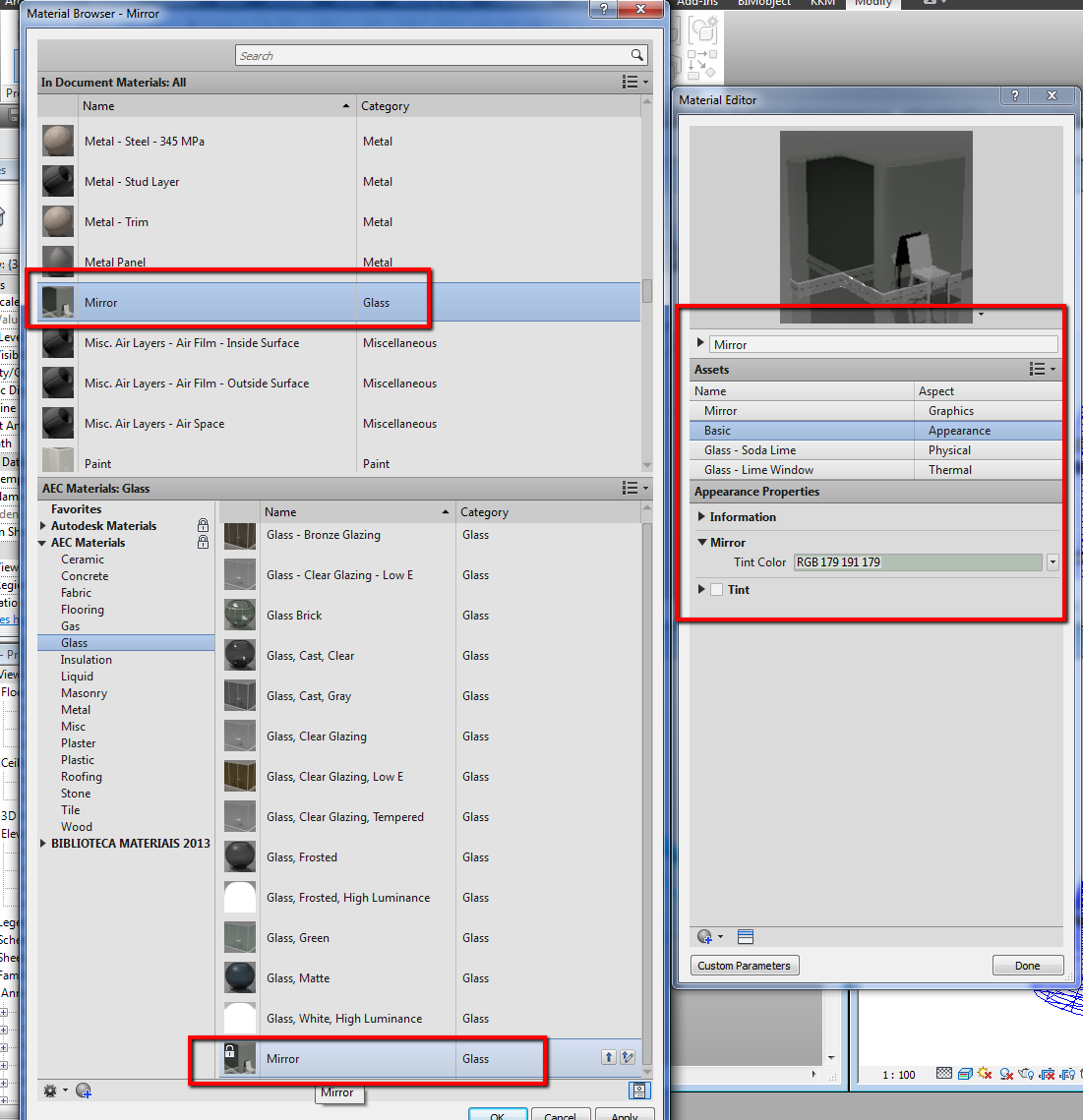

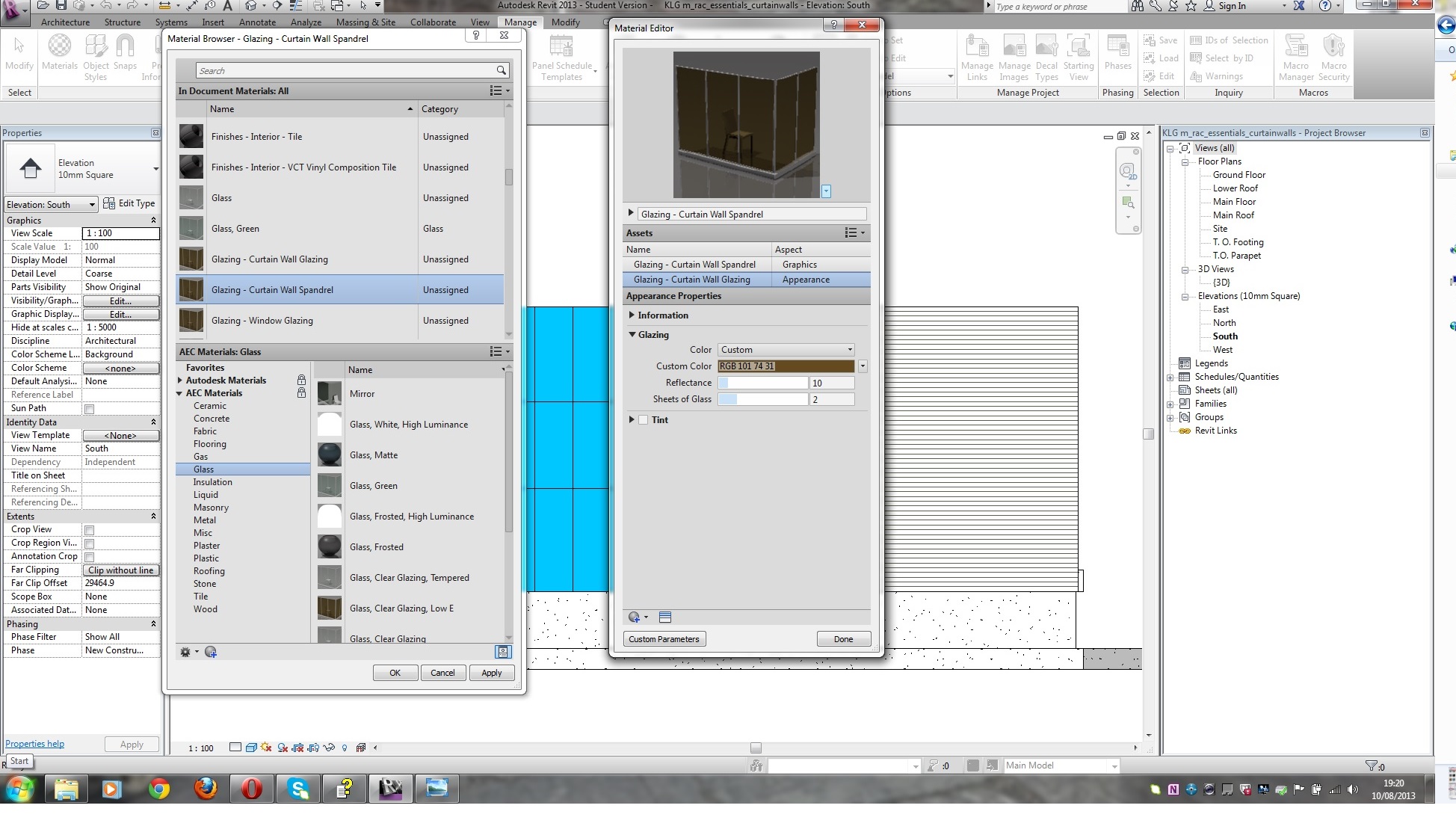

Sat, Aug 10, 2013 at 2:17:18 PM | Rendering - glass?!
CharlesDickens99
Joined: Mon, Jul 29, 2013
19 Posts
Hello everyone,
I am using Revit 2013 and am something of a novice.
I am trying to create semi-transparent glass.
I know one poster here said that different materials have different properties but if you look at tiles you find transparency but if you look at glass this option doesn’t exist which is bizarre.
I attach a screenshot of my material editor where I am trying to edit glass. I cannot see a transparency option. Any ideas what I am doing wrong?
Thanks in advance.
Sat, Aug 10, 2013 at 2:32:05 PM | Rendering - glass?!
#9
dgcad
dgcad Avatar
1231 Posts
3.5 Stars: 36 Votes
It could be because a you have selected Curtain Wall Spandrel Panel Glass which is not really glass. Or at least not generally transparent glass. Try clicking on the plain jane 'Glass' Material.
