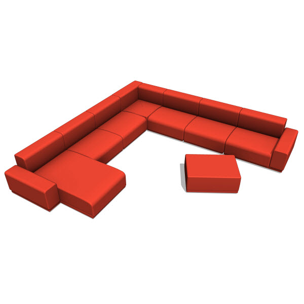

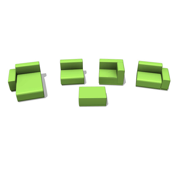

also the attached pic is a family we will be adding this week to our site which contains 6 family types within in the single file that lets you create any type of sectional you want. here is the real product page... http://www.vitra.com/en-us/home/products/place-sofa/detail/ look for it on TRC later this week!
