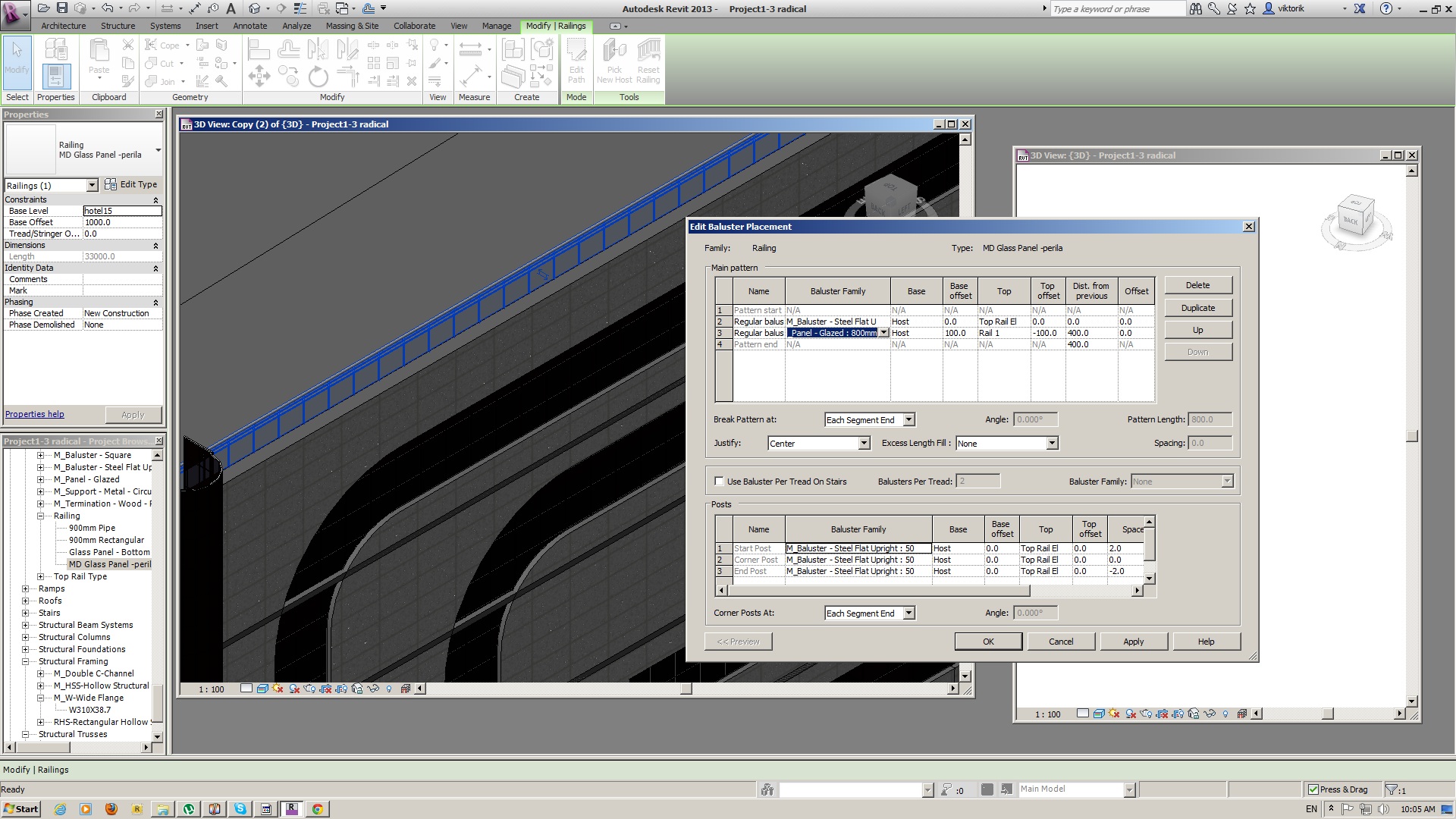

Does anybody know how to modify glass from railing ''glass panel bottom fill''  railing - revit 2013 , or how to change properties for one railing, or I must create new fomily?

I'm looking at your second image and you have some of those "glass panels" families in your library, you can use one of them or create a new one...

oh, yes I foundet that panel , I saw it at construstion asembly but i was searching where to change it's material to mine , after that it was in family tree at railings , separately panel 800mm ...
thanks!
