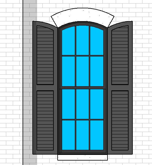

I'm trying to create a brick soldier course for arched windows and openings. The windows already have an arched header built into them, and the material can be specified in the Properties menu. This works fine with materials that use simple surface patterns like precast or smooth stone (see attached .jpg), but for an arched soldier course, is there a way to create a pattern with arrayed lines that will adjust properly to the radius? Or, is there a completely different way to go about this that I am overlooking? Any suggestions would be greatly appreciated. Thanks!

Thanks, Typhoon. I actually read each of these threads before I posted my question, but none of them addressed my specific issue. The one that came closest was the one that you personally responded to. It included three links to video tutorials on this issue, but none of those links are still functioning.
