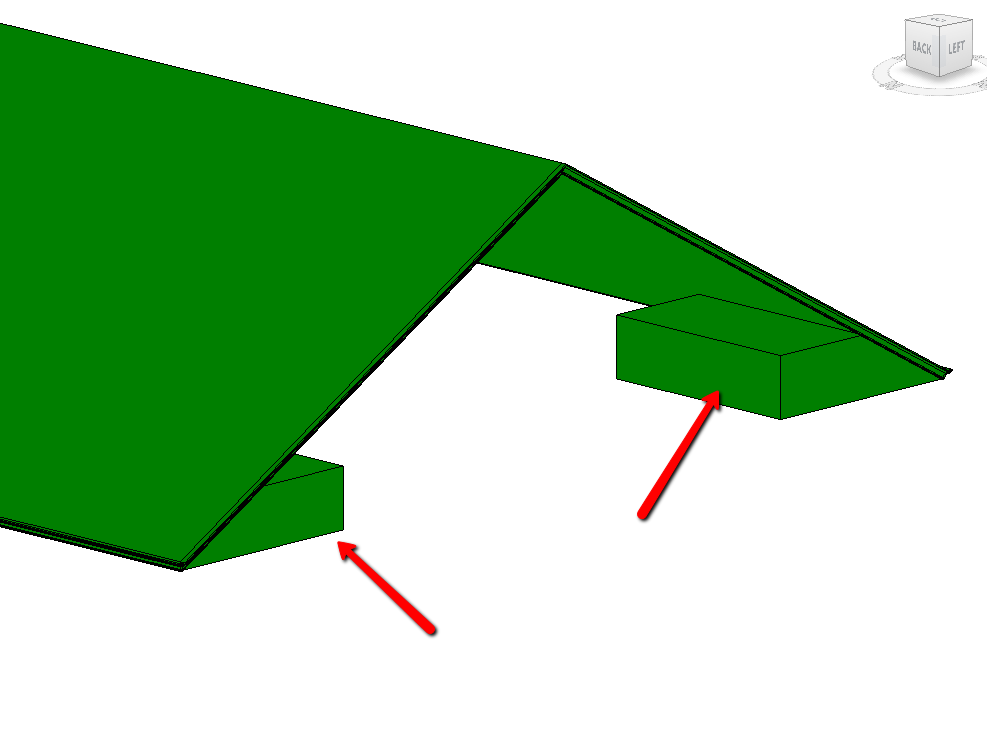

Hi good day,how do i create the profile used on the roof indicated in picture,especially the gable end.Should i use the soffit
or fascia profile or both. I'm Willing to learn more and more even if my question sound a bit stupid.I just want to learn the corr
procedures.

ROOF FASCIA

And "roof soffit" to create those soffits if you want that too....
