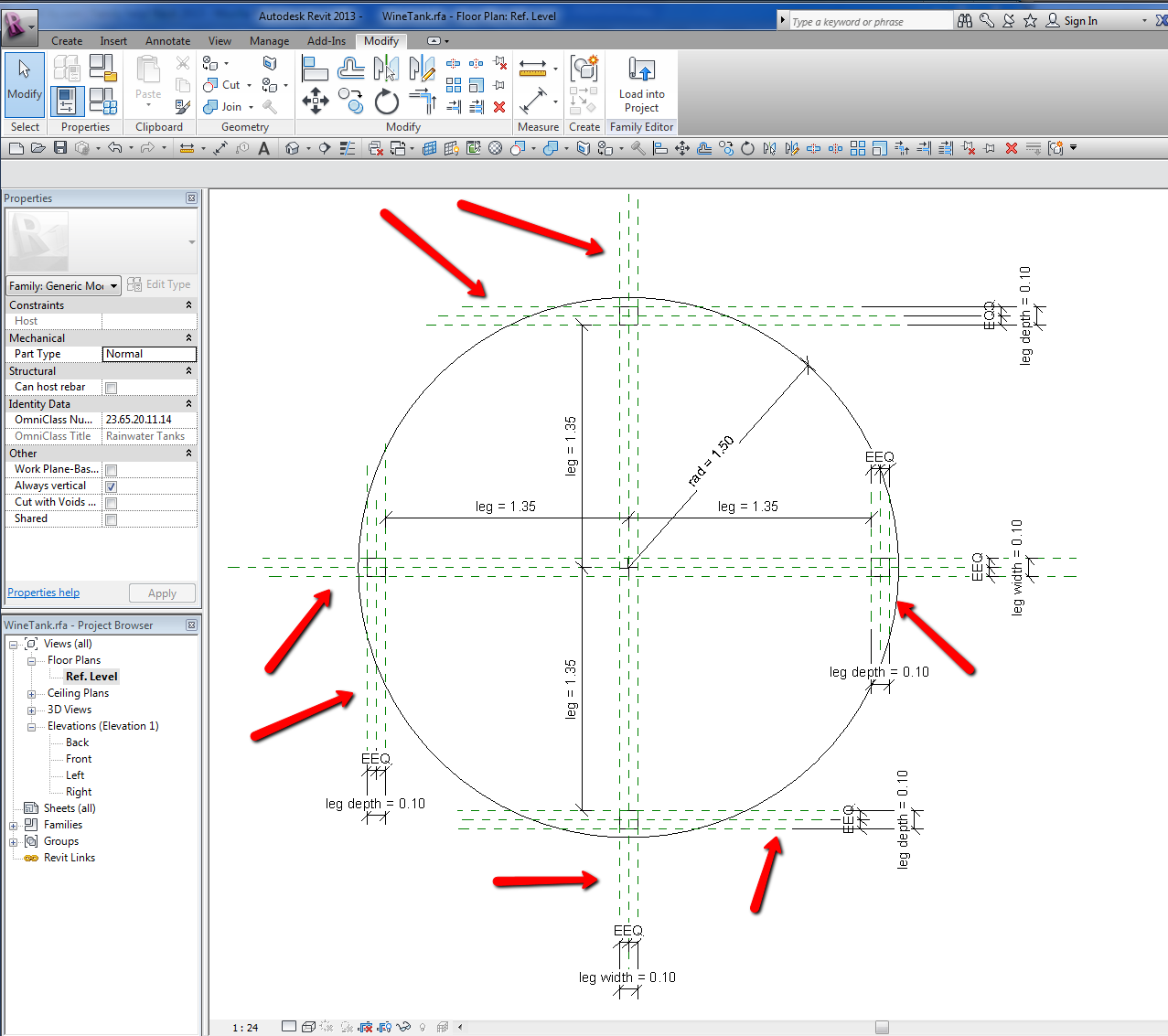

I am a newbie and need some help with my wine fermenting tank family.  I can't figure out why I can't get the legs to move when I change the size of the tank.  It should be as easy as table legs, no?  I'm at a loss.  Please help!!

Creation families RULE 101 - Create ref. planes, create dimensions between those ref. planes, then create parameters, flex the family to check if everything is working, now create the objects and align / constrain those obj. to the ref. planes.

many thanks!
