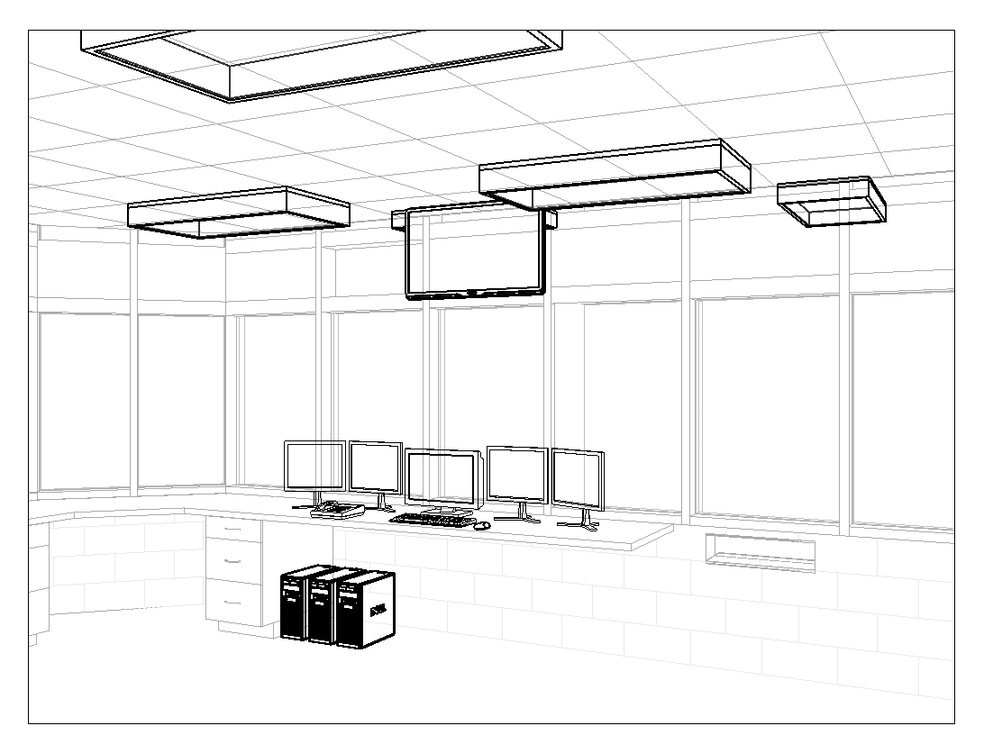

I'm working in Revit Arch 2012 and MEP 2012 and I place in some family objects and I can see the walls behind them showing through.
I cannot figure out how to stop it.  Visual style is set to Hidden Lines.  I've attached a photo of what's happening.  See how the ceiling patter and wall pattern, and window frames are clearly visible through the light fixtures and LCD monitors??
Anybody know how to fix this or what's going on?  Thanks!!!

I checked Visibility/Graphics overrides for that floor plan view and for that 3D view and nothing is checked as transparent.
What I am doing is, linking in an architectural revit model into another revit file and adding these devices to the newly created revit file.  the walls, floor, ceiling, casework, etc are all in the background/linked in file.  That's the only common factor I see, all the lines in the background/linked file are showing through objects that I place in the new file.  Any way to fix that?

Look at your window property dialog, check discipline. If you change this setting you should see some different looks, think you are set for MEP, try Architectural.

Thanks for all of your suggestions.  Steve was correct.  Once I found the window properties dialog (took some hunting around), it was set for electrical.  When I changed it to Architectural it looked the proper way.
