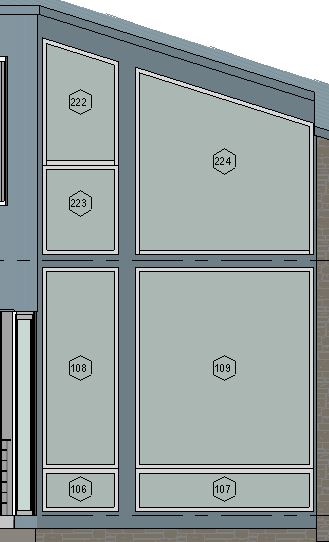

As you can see in this picture, 106-109 are curtain wall panels converted to windows, no problem. 222 & 224 cannot be
converted to windows.

You can edit a CW sketch - just like any wall - to have a perimeter of any shape and the perimeter mullions will follow that shape.  The panels can also be any shape.
Wed, May 16, 2012 at 1:34:40 PM | Can only square panels in curtain walls be converted to windows?
Now I think I know what you are asking.  You are swapping the panel for a window.  You are right - a window family set to be rectangular will not go into that panel shape.  You would need a special family to do that.
We use curtainwalls all the times to represent windows.  We just use a wall tag designed to look like our window tags.  You could do the same.

You can schedule the individual panels and you could tag those with a window like tag.  BUT height and width will not schedule for non-rectangular panels.  Of course it doesn't really work for non-rectangular windows either.  The area of the panel will schedule no matter what the shape.
