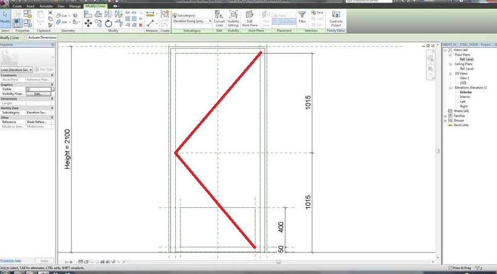

Hi All,
door swing line in elevation, i am not able to make it work properly, can some one help. see attached.
i am using Revit Architecture 2012
Cheers,
W

What are you trying to do with a door swing line in elevation? Something like the attached?

yes indeed, but a dashed or hidden line visible in both internal & external views. thx for the help. W

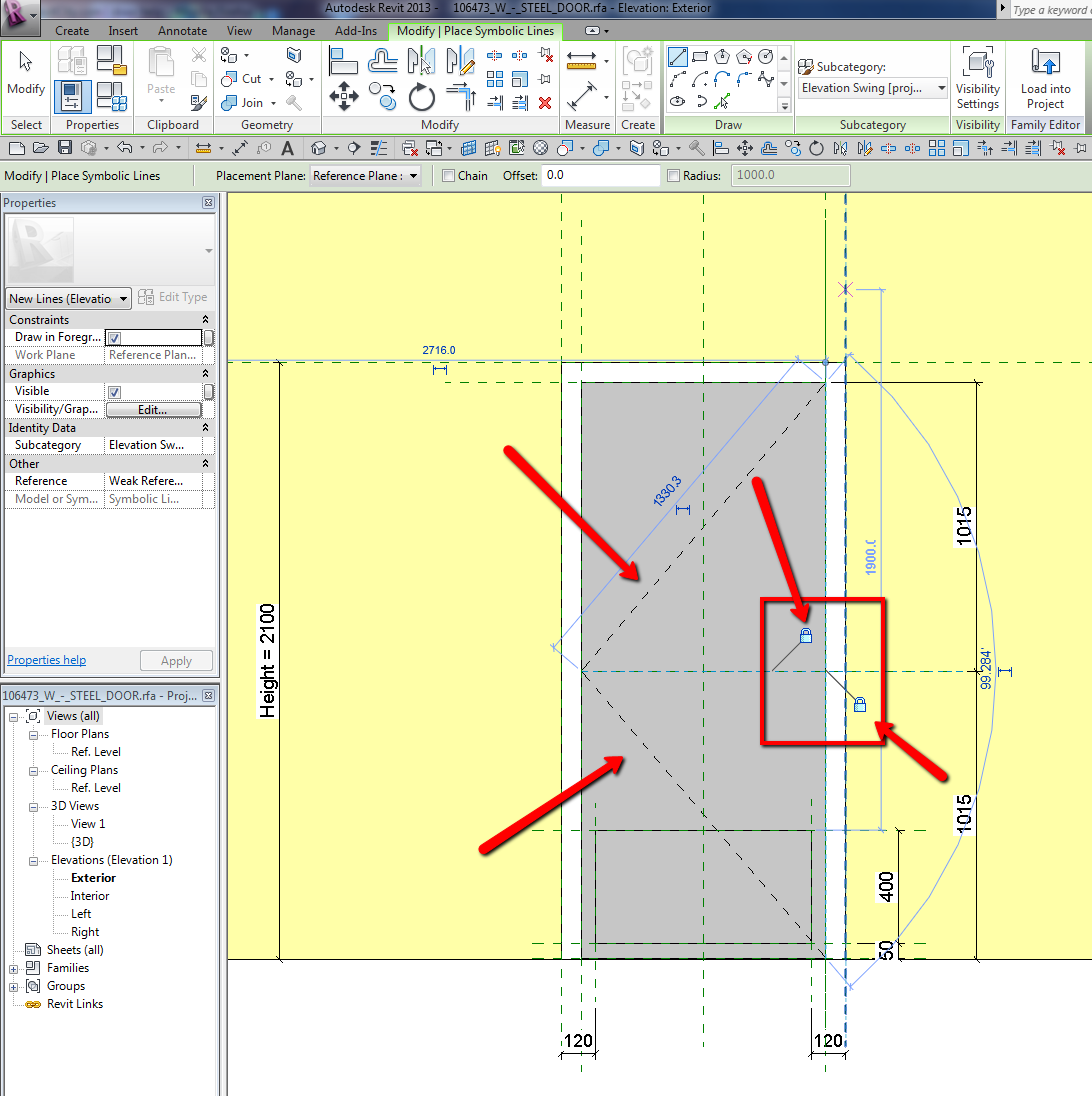

Wed, May 16, 2012 at 1:10:01 PM | door help
Joined: Tue, May 22, 2007
5921 Posts
4 Stars: 205 Votes
Create the "Symbolic Lines" and lock those padlocks
Thu, May 17, 2012 at 1:21:53 AM | door help
bjwson
Joined: Sat, Nov 25, 2006
66 Posts
2.5 Stars: 3 Votes
thank you.
