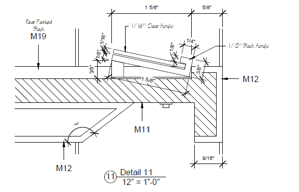

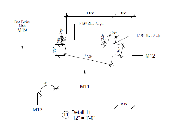

I am having the same problem. In a roof plan, my walls show up under the roof just like I want them to. I have adjusted the roof transparency to 50% and made the walls dashed. Everything looks fine. But when I print (and in print preview) they all disapear. Except one specific wall type that is concrete with a stone face. In some places that one specific wall type is not under a roof.
I tried the raster trick that TKennedy suggested. It sucessfully printed the walls, but all of the building is very light grey and hard to see. All the annotations print full black. When I switched back to vector it printed the same as it did before, no walls besides the ones mentioned above.

You got exactly what you told Revit to do.  Setting the roof to 50% transparent is your problem.
Read this item in your HELP:  It will show you how to show items overhead.
Changing Line Styles for a View Underlay
It will come up if you search using "overhead"
