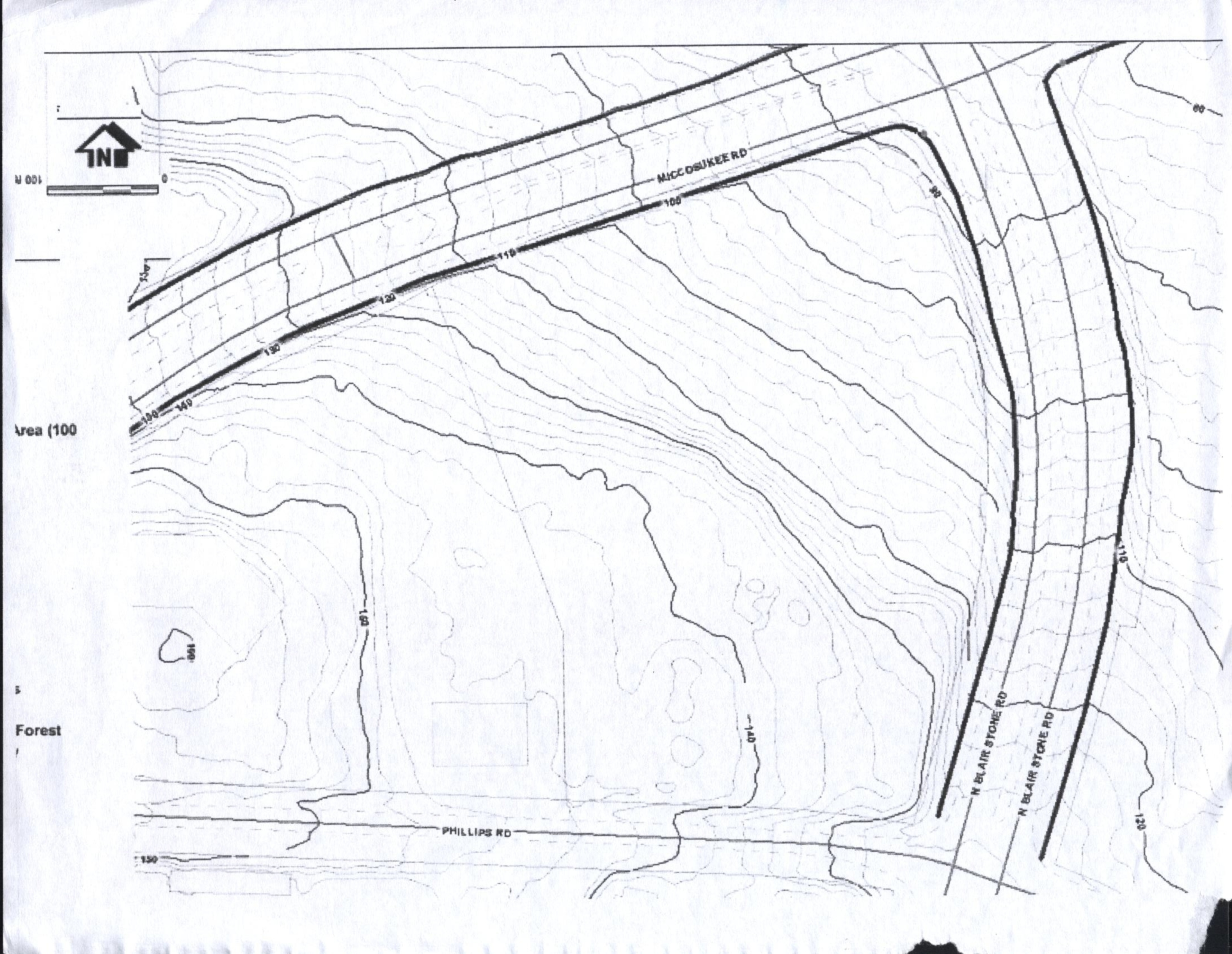

Hi. I'm not sure I'm posting this in the right place,but I desperatly need help.
I have to create a toposurface from a image file, and everything works fine. The second I hit finish surface, I get an erorr and Revit closes without giving me any options. The error is displayed for so short,that I don't get to read it.
I think it might have something to do with the surface having too many points. I hit simplfy surface before finishing the surface, and it doesn't help. I already created it 3 times. Same error.
What am I doing wrong? What is happening? Are there any settings I missed?
I am quite new to revit, (still a student) and I have a project dedline very very soon.
I atached the image I am working of.Thank you very much.

Hi.Thank you for answering. I reatached the image.
First of all, I'm not creating a topography from a cad file, I am manualy imputing the elevation of the terrain, using the create Toposurface tool.
I have Windows 7, Amd Phenom 2 x6, 8 gb ram and an Nvidia 460GTX.
Any ideas?
