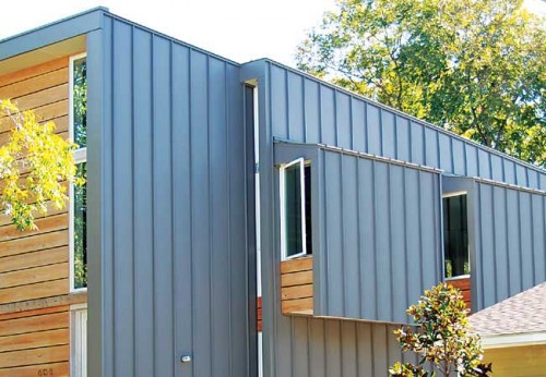

I am currently trying to create a "corner wrap" from the wall around the roof (See leftside attached pic, where the galvalume goes up, around, and frames the wood siding)...where do I even begin to do something like that inside revit? I would imagine I just have to model all of corners...and assign them as "walls" or "roofs." But that just...doesn't seem right to me. Is is a wall sweep issue? Very stuck here...

Are you asking about a Rake Flashing?  This could be a roof edge sweep.  You can do it in place or use the roof facia tool < that would be better.

however the exterior/outside corner of the two walls, is still giving me grief...I cannot seem to find a tool that could cap the corner... any suggestions there?

I would use a vertical wall sweep there.  This is a flashing in real life ... and so it is in Revit.

Problems: SOLVED
