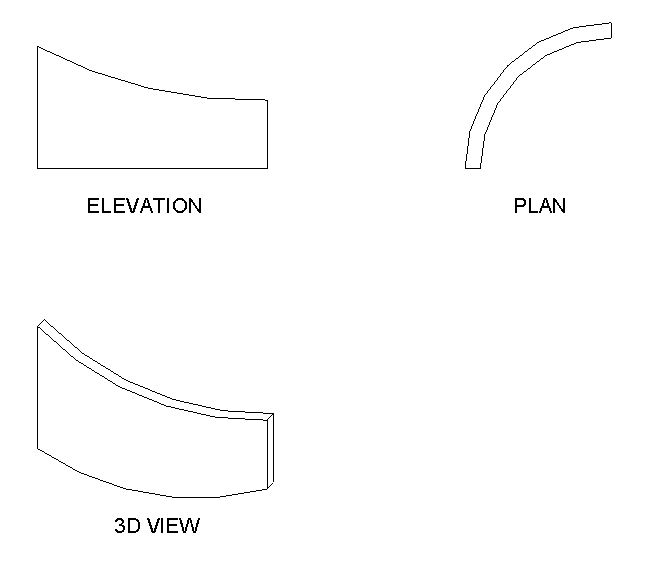

What I am trying to do is create a curved wall that also slopes up. (refer to attached) I have tried
  • Creating a basic wall and editing profile
  • Creating an In-Place mass and trying to sweep a void along the path
  • Following revit help steps to try and create an odd shaped wall
I have not been successful in finding a solution.  I do know that somewhere in Revit it will allow me to do this, but I am just having trouble finding it.

You cannot edit the profile in a curved wall.
You have several ways to cut that wall like you want:
- Goto an elevation/section view, create a ref. plane and use the "cut geometry" tool to cut the wall, if you delete the ref. plane the wall goes to original form.
- In plan view create a ref. plane near the wall, select that ref.plane to be your work plane, go to an elevation or section view then create an in-place family in Wall category and create a extrusion VOID, use again the "cut Geometry" tool to cut the wall with the void.
- Create an IN-PLACE in cat. Wall then create a "Swept Blend" void, select the curved path and create two profiles, here you have another thread about this laspt process: http://www.revitcity.com/forums.php?action=viewthread&thread_id=27094

Thanks for those suggestions. In the end we just used the straight edge in "Attach top of wall to reference plane" instead of having that curved elevation.
