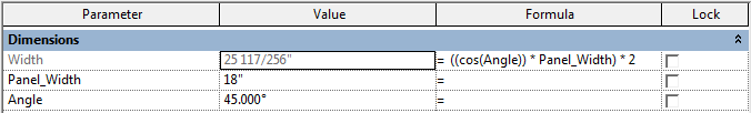

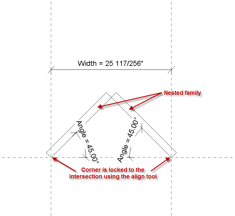

I did a quick test, and it does look like it's possible to create a parametric bi-fold. I only tried it with two panels, but that worked, and adding more should be possible. I used nested families for the panels, and locked them to ref plane intersections, not to each other (see attachement). Then I used some trig in the formula to drive the Width parameter (in a full family this would be a separate 'panel open width' parameter). It seems to work just fine.
As WWHub said, Revit doesn't seem to like 90° and 0° angles, but that seems to be confined to testing inside the family. Once the family is loaded into a project, it seems to (generally) work ok. If any angle other than 90 or 0 is working in the family, 90 and 0 will probaly work in the project.
