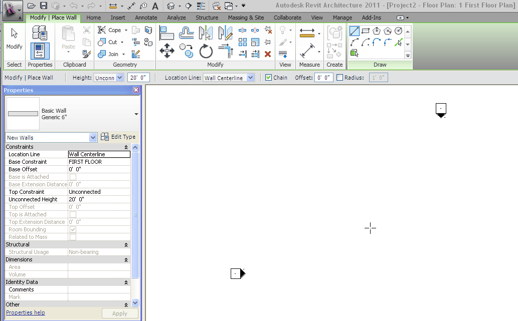

When you say "when I select 'new wall' the generic wall types are missing." what exactly are you doing?  You have a project open, on the modify tab you click WALL, then in your properties type pulldown there are no walls available?
Mon, May 14, 2012 at 8:30:38 AM | Generic Walls Missing
Open a plan view then click on "modify place wall".

You should have a generic wall ... but even if you don't, you can use any wall as a start and create a new type from it.  It does not have to be the generic wall.

I would assume that it has to do with the software because you should have a Generic 6" wall already.  Walls are a system family so there aren't any to load.  You can just make a generic 6" wall to follow along with the book.
Oops my bad WW you got your post in before me!
