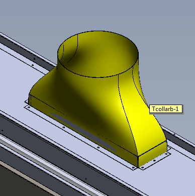

I am trying to make this: see attachment Duct
However, I keep getting this:  see attachment Bad Duct
I am not very good at blend, revolve, etc...
If anyone could please make this for me, along with instructions, that would be great! Smile

I used the Extrustion-Blend method.  Starting with a 12" rectangular bottom, and a 6" circular top.  I then performed a a similar Void Form-Blend by offsetting the previous dimension 1/4".
I would just like for it to be more round in the center, like the duct attachment.  Mine, the bad duct attachment, doesnt appear to be as spot on as i would like it to be.

Instead of the void, just offset the rectangle and circle each the duct thickness.

Tried that.  Error message stating that I can only have 1 enclosed loop.
